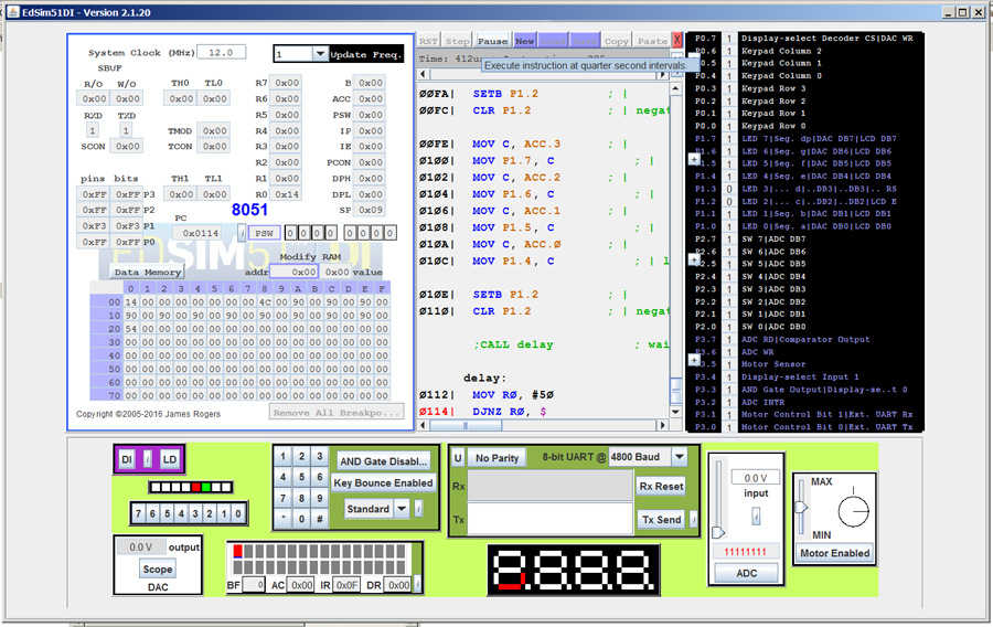

I'm like 12 years too late. I have the same out of range issue with JB, though my code is kinda long. I meant to interface keypad with LCD on edsim51. Can someone help me out?

I've attached the code i'm working on. Its suppose to display whatever you press on the keypad in edsim51 simulator to appear on the LCD. The LCD is set but the value is not displayed. I honestly don't know what is wrong, i just need help.

To other members - I think the last time I did anything with 8051 code was 30 years ago and I do have an 8051 board around here somewhere. EdSim51 was simple to download and run on win (it is java).
I had to rewrite the whole code but now it works. Thanks

Thks. I did load it in but it does not work for me - does something but not displaying as I thought. There are lots of settings and so forth so there are probably some good reasons why. Anyways, I am glad that you got it working ok.
