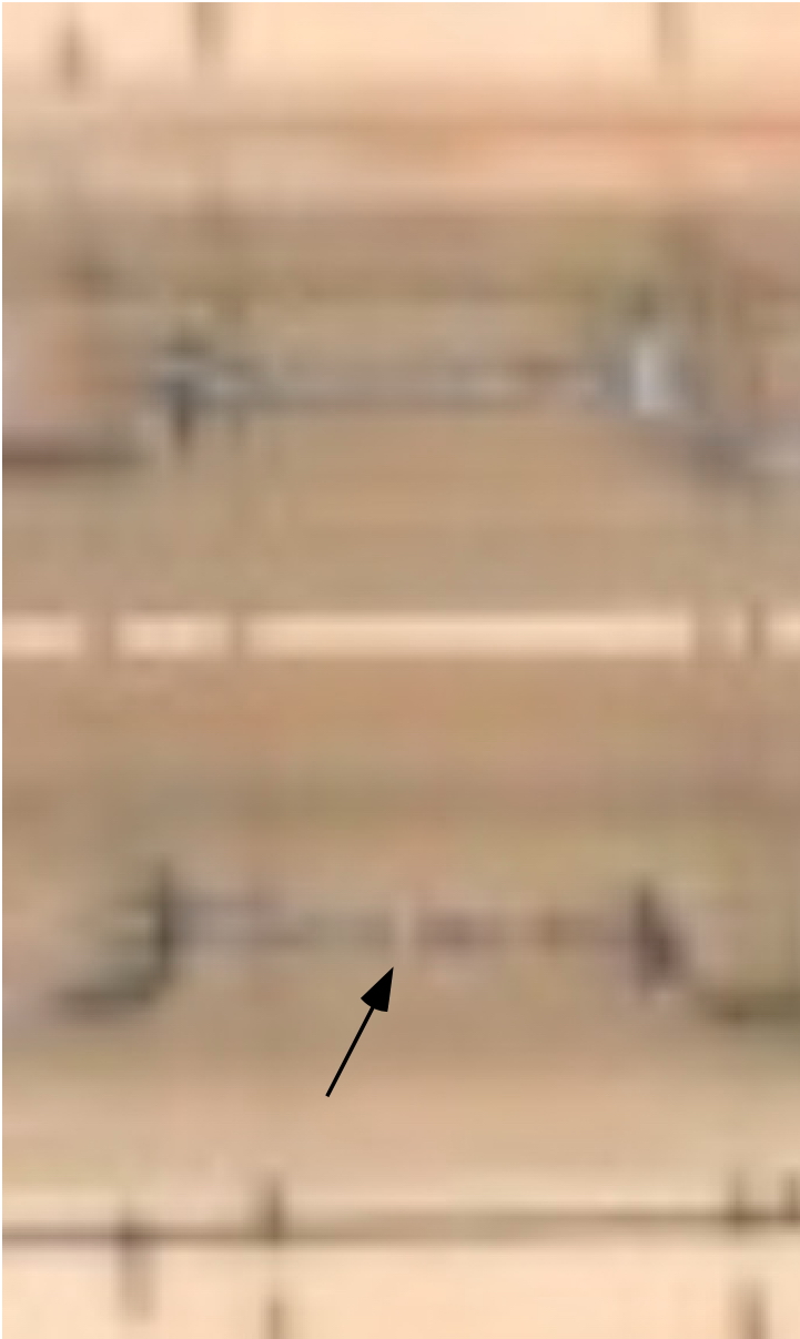

I have a friend who has a crossover that's not working.. So here is a picture of it i checked the bulbs, resistor and the coils which all tested good..
I tested the coils and no broken wire or anything... I'm lost.
No sound going to woofer and I swapped with a known good one and still no sound... Tweeter works fine however

The bulbs could "TEST GOOD", but be bad. The bottom bulb in your pic is my suspect.
What I would do is short out the bulbs with a wire.
Are those "bulbs" or fuses? If the latter, it would make sense one could fail and take out the woofer continuity.
What would a bulb be doing in the circuit?
EDIT TO ADD: I zoomed in on the "bulbs" and the lower one clearly looks blown in the center of the conductor.

It's a simple low pass filter with a single inductor and cap on the LF, the rest of the circuit is for the HF. Check each line in turn for continuity from input to output. Work your way back towards the input with one lead of the meter. If need be, test the actual PCB traces for a possible crack by scraping a smidge of resist off etc. It's not uncommon to crack the board around an inductor mount/ tie wrap etc when the cabinet is banged around. Bose and H&H/ Fane setups etc sometimes use polyfuses for protection as well as lamps, but I don't see any on your board, just the lamps. Lansing generally mark their protection lamps with a dot of coloured paint, so if they have failed, replace both at the same time with the correct ones. They are available from JBL, but you need to tell em what colour the dot is.
I still can't believe I'm the only one who can see the bottom "fuse" is blown in the center. The input line labeled "+W" looks like it runs directly to the end of the fuse.
The pictures too small to tell - you might be simply imagining it.
But in any case, simple ohm meter tests (as you would automatically do before posting such a trivial question on a forum) would immediately find such a fault (faster than typing the question here).
