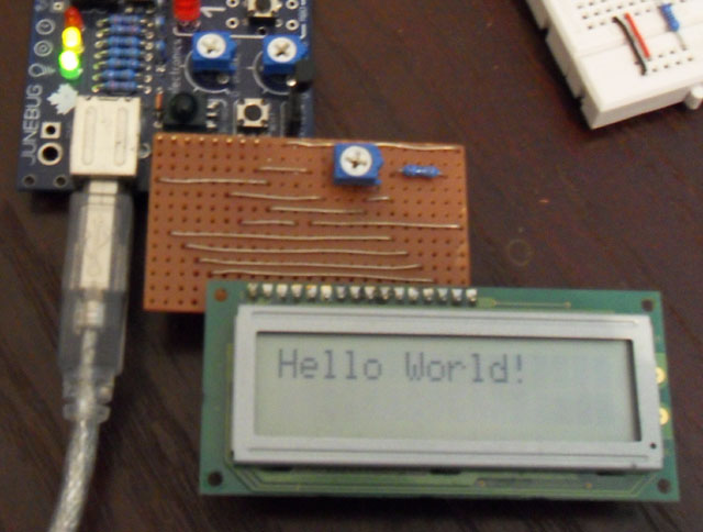

can a lcd (16x2 chars HD44780) be connected to con8 of the jbug or would it be better if i took the 18f1320 off the bug and used a breadboard? if i need to use a bread board what other bits do i need to add to it? sorry if i havnt been clear its late and i am cream crackered! lol maybe i should ask in the morn.
sorry to bother you all again with another question :D
I made a very crude adapter to connect to con3.
isnt con3 connected to the 18f2550 that does the programing?? if so wouldnt programing it mess up the june bug programing the 18f1320?? or have i got something very wrong again? :D would you mind explaing how your set up works for me please pommie as i would hate to mess the bug up as i am starting to like it in a odd kind of love/hate relationship lol:D:D

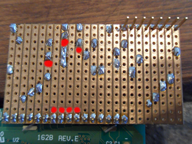

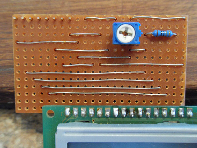

Sorry, I meant con8. Here are pictures of front and back and the code I used to access it,

I have no idea why I used a resistor but it's a 330Ω one.
