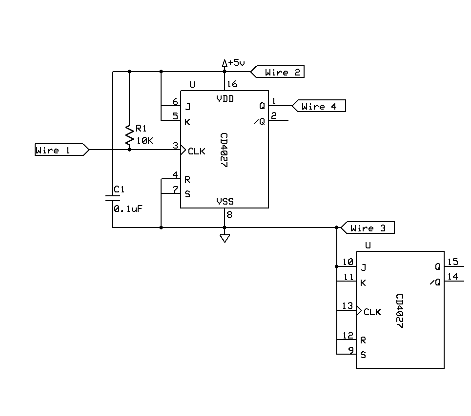

hi i am new to electronics and i would like some help to wire up a jk flip flop to halve the speed of an electronic pulse.
i have an after market cruise control in my car and it requires a 5v+ pulse of around 4000 pulses per mile. the supply that my car sends to the speedo is about 8000 pulses per mile.
so i have got a jk flip flop which i plan to use like a topple type flip flop.
the schematics for the part are above.
the 4 wires that i have available in my car are
wire 1) 5v+ pulse that is from the speedo pulse
wire 2) 5v+ constant power
wire 3) 5v-
wire 4) output (needs to be half the speed of wire 1)
could someone please help me to tell me which wire goes to which pin/pins on the flip flop please
thanks in advance
Here is a schematic of the connections
use a 4017 counter and reset it after every other pulse, ie use feed back to reset at
2nd count. see data sheet to know how to connect.
