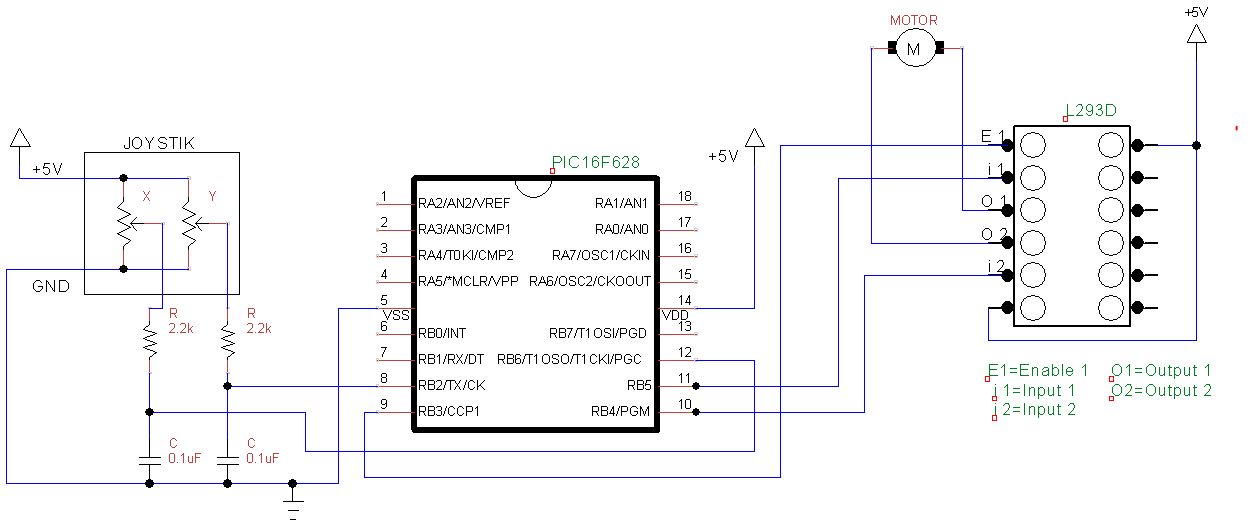

Hello people!
I am working on a radio controlled motor application. I constructed the circuits mostly based on Nigel Goodwin's PIC tutorials. Actually, the code is also basically from those tutorials. I just combined, copied, pasted some code with another. These are , PWM, Manchester encoding, Joystick reading and delay code parts. So i haven't written any of this routines. As i said i just combined parts that i need in order to meet my needs.
To test the Analog Joystick reading part (Tutorial 4) i connected joystick to PIC16F628 (PIC that i used) and PIC to motor driver (L293D), and a DC motor to it. The overall schematic should be included in the attachment. For a start i tried to read only X axis of analog joystick. So as a result, i wanted to get the motor roll forward and reverse according to X axis position. Also, i am using mini analog joystick, rather than PC analog joystick. The picture should also be included in the attachment.
So the problem is, it doesn't work. As soon as i turn the power on, the motor starts to turn. That's all. Please, help to figure out whats wrong. It should be in the code, that i have messed up.
This is the code:
  LIST    p=16F628        ;tell assembler what chip we are using
    include "P16F628.inc"        ;include the defaults for the chip
    ERRORLEVEL    0,    -302    ;suppress bank selection messages
    __config 0x3D18            ;sets the configuration settings (oscillator type etc.)
    cblock     0x20             ;start of general purpose registers
        count            ;used in looping routines
        count1            ;used in delay routine
        count2
        counta            ;used in delay routine
        countb            ;used in delay routine
        temp
        tmp1            ;temporary storage
        tmp2
           HiX            ;result for X pot
        LoX
        HiY            ;result for Y pot
        LoY
        Flags
    endc
JOY_PORT    Equ    PORTA
JOY_TRIS    Equ    TRISA
PotX        Equ    0x06            ;input assignments for joystick
PotY        Equ    0x02
MR    Equ    0x04    ;pin for motor reverse
MF    Equ    0x05    ;pin for motor forward
;pin 3 (RB3) is the PWM channel output -CCP1
        org    0x0000
        nop
        nop
        nop
        goto    Start
        org 0x0010
Start        movlw    0x07
        movwf    CMCON            ;turn comparators off (make it like a 16F84)
Initialise    clrf    count
        clrf    PORTA
        clrf    PORTB
SetPorts    bsf     STATUS,        RP0    ;select bank 1
        movlw    0xff            ;make all joystick pins inputs
        movwf    JOY_TRIS
        bcf     STATUS,        RP0    ;select bank 0
        call    JOY_Init        ;discharge timing capacitors
        call    PWM_Init        ;
Main
        call    ReadX            ;read X joystick
    ;    call    ReadY            ;read Y joystick
        MOVLW    LoX
        CALL    SpeedL        ;half speed forwards
        goto    Main            ;loop for ever
