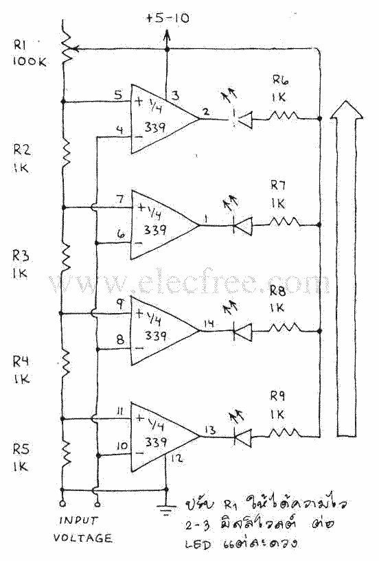

How hard would it be to convert a potentiometer type joystick like the ones in the links above, to an 8 way switch?
what would you need to say have a circuit open or close depending on the pot location?

This is from the old F. Mims series sold by Radio Shack. It simply puts into a schematic the type of circuit blueroomelectronics (Bill) just suggested. As drawn, you could have four set points for each axis, but it is easy to see how that could be increased or decreased to just one or two per direction by adjust the resistors/setpoints. Then, instead of LEDs, use relays or an electronic switch for each setpoint.
Sorry for the quality of the schematic. I copied it from the source shown. John

Well one comparator per relay some low power relays could probably be run directly from the comparator output. Many users could provide you with better schematic. An LM339 is a quad comparator IC. How much current do you want to switch?
There will only be maybe 100 mA at 5 vdc so where not talking abuot a lot. I will most likely be designing a PCB so this is something that I could integrate.

As Blue mentioned before, just use comparators if you want to use a joystick. the joystick will control 2 pots, one per axis. When the joystick is centered, the pots are centered. Look up on how pots operate. All you would need to do is put 2 comparators on each pot output. the comparators would have tripping points at >40% and <60%, for example (pot is 50% when centered). This will require more work than finding a mechanical version, and might end up with a larger project than what you want.
