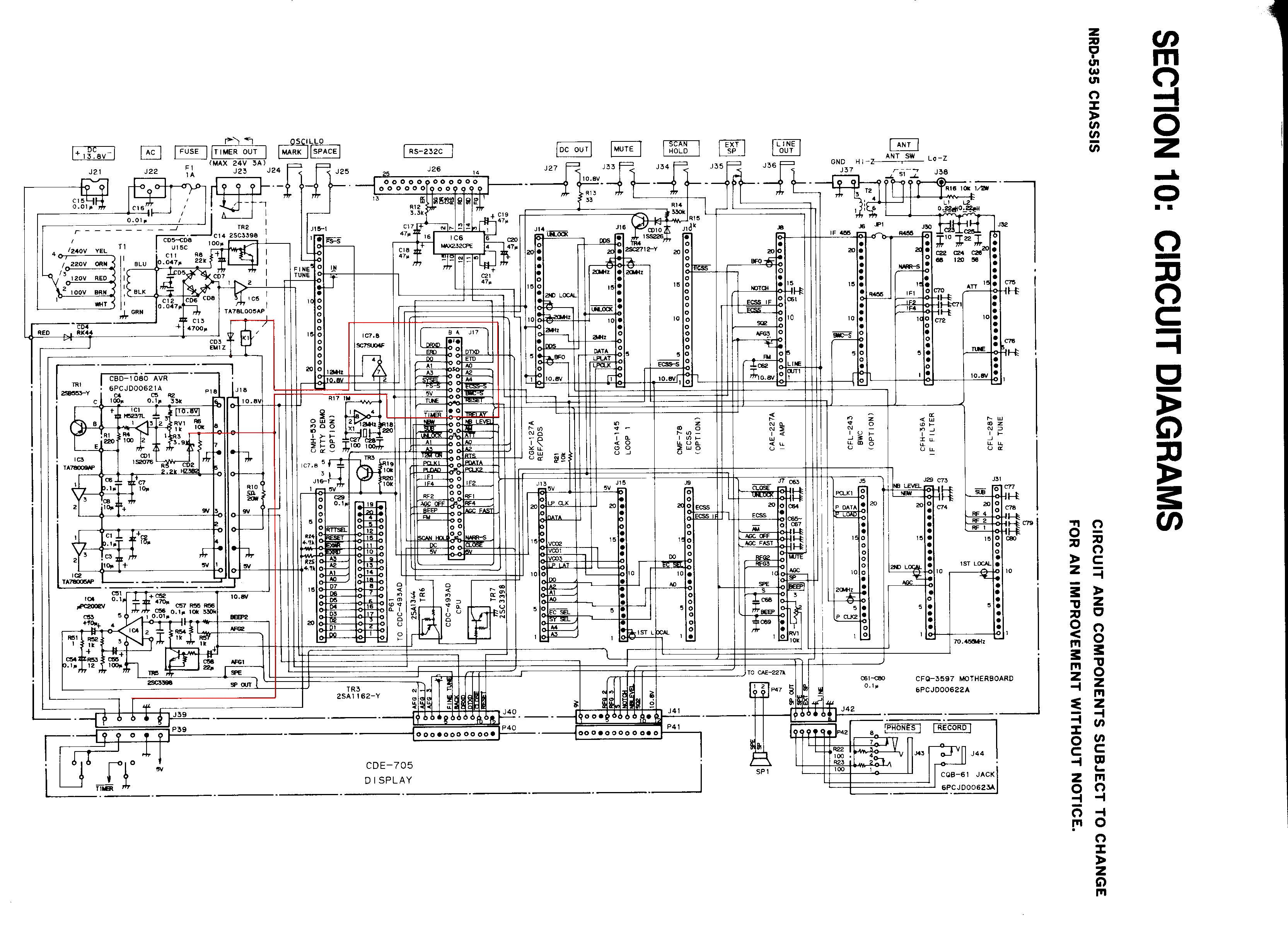

I have posted a circuit diagram of the chassis, which I can crop if necessary and also have access to the service manual pdf.

What voltage do you have at the emitter of Tr1?
What voltage do you have between the emitter and base of Tr1?
Does the voltage vary at pin 3 of IC1 when you adjust RV1?
Does the voltage vary at pin 1 of IC1 when you adjust RV1 ?

What about the two diodes? CD1 CD2
What about a short on the 10.8v rail? is the series transistor TR1 getting hot?

Joe,
I marked up the cct showing the conenctions for CD2...Looks like it is connected to some timer circuitry on the main board?
You should be able to lift off the cathode connection of CD1 to the chip ...See what happens...the supply should return!
Also check if the relay is energised, K1, its also fed from the output of the bridge, does it have any voltage across it?
The timer switch isnt set is it? Look at the bottom of the drawing at the multipole connector J39/P39
I've attached the internal circuit of the M5237l for reference

Hello Chippie, you were right! Disconnected the cathode and back came the 10.8V! Trouble is, the radio still doesn't switch on. The display is much brighter, but basically the whole display lights up and none of the controls will work. I'm going to try a replacement for CD1 (1N4148 looks ok from the data sheets) and cd2 (BZX79C 3V zener?) and let you know what happens. I will also check out that relay. Thanks for your help so far,
Joe, the relay doesnt do much...the cct shows it as an externally available set of c/o contacts...
You need to find out what is pulling the reference voltage low...CD1 and CD2...they go to another connector on the board...Did you try the timer switch?

Largely thanks to your help, I think I'm getting somewhere. I decided to to take a different approach and strip the chassis right down, which also meant I had much better access to the traces on the MB. BTW, J39 goes to a DPDT switch....the timer is just part of the main switch. Apart from the 5V rail, which goes direct to the front panel, I think for the clock.
Anyway, I noticed that the output of pin 8 ( the diodes) was not getting to J39 and , looking closely, I found a broken trace on the pin 8 output just before J39. I guess the most likely thing is that something caused it to blow, so is there anything I should look out for ? Thanks for the help so far.
