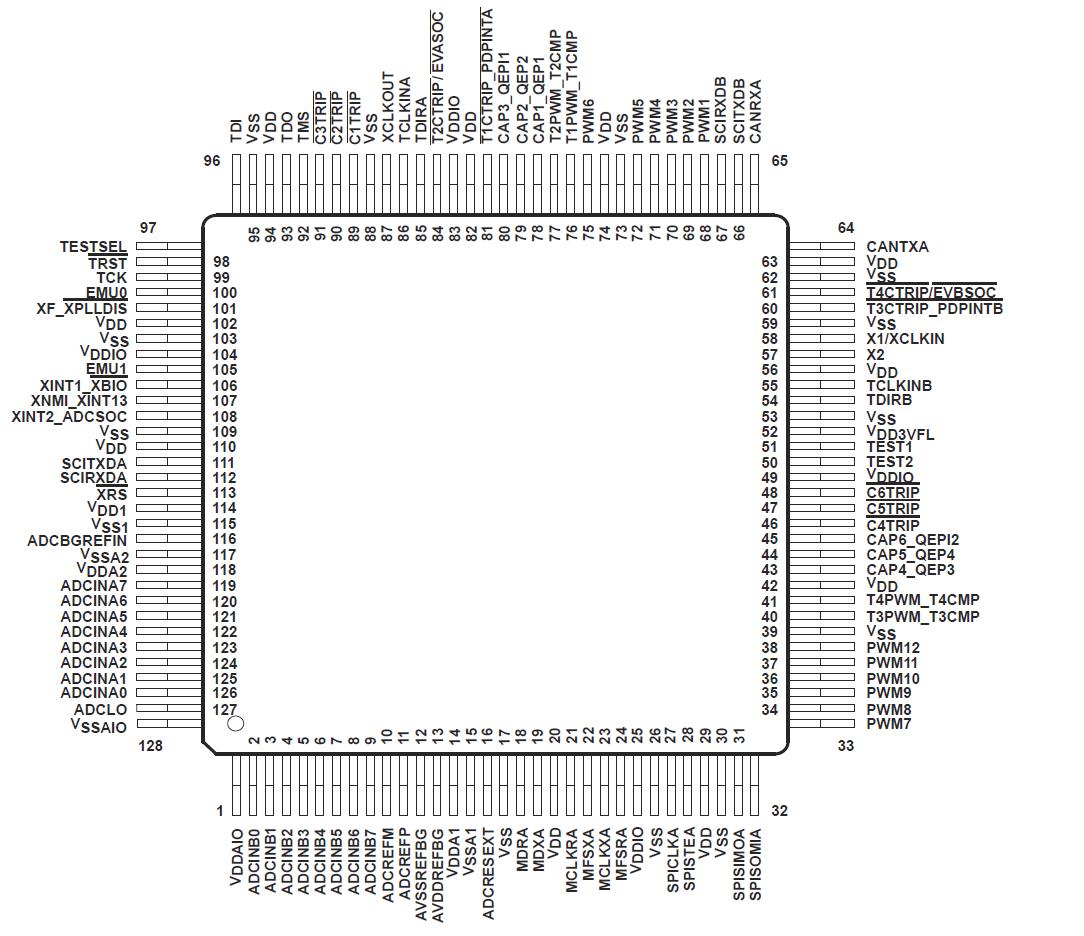

I am trying to read a TMS320F2810PBK chip
I have purchased a JTAG programmer Flashpro2000 but cannot seem to get it to read the chip. The supplying company are not very helpful as the chip is on a board which does not have a JTAG Header.
TMS320F2810PBK is JTAG compatible

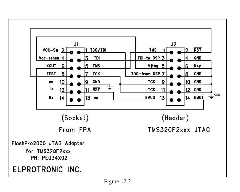

![jtag.jpg jtag.jpg](https://www.electro-tech-online.com/data/attachments/55/55955-87656d586aee9c1be0f26d7b431f1361.jpg)

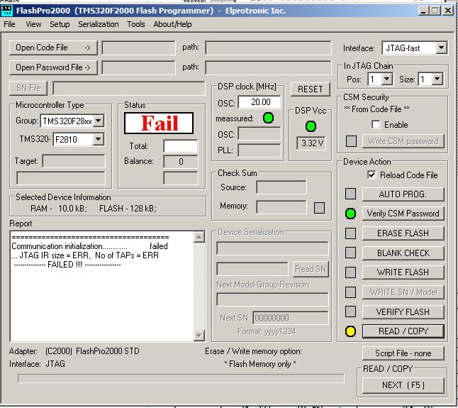

Have made all the connections correctly but reader shows this error
![Prog.jpg Prog.jpg](https://www.electro-tech-online.com/data/attachments/55/55956-7e42d60360a2c7032546a43b4f492dfa.jpg)
Anyone familiar with Jtag ?
