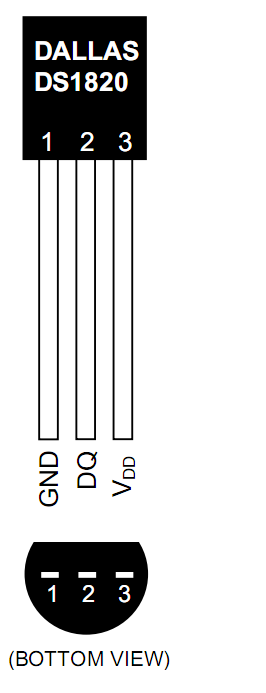

i have a number of DS18S20 and i assume i can connect theese to the junebug directly via con4, what i would like to know is wich way round do i connect it? i have looked at the circuit diagram for con4 and to me it looks like i cant just plug the DS18S20 into it as the pin config is wrong (5v centre pin) does that mean i have to mount the DS18S20 on a sep board and wire from that? i have included a diagram from the DS18S20 data sheet

Con4 has A3, A4, Gnd and so you can plug a DS1820 into it. You just have to make A3 output and high to power it. Or, you could use parasitic power.
Was you looking at Con5?
i was looking at con4 according to the circuit diagram in the assembly manual. i may be reading it wrong :D i will post a pic of it from the manual. wich way round do i put the DS18S20 into con4? thanks pom
Just make sure the gnd pin is connected to ground and all will be fine. You can then make A3 high and use A4 as the OW pin.

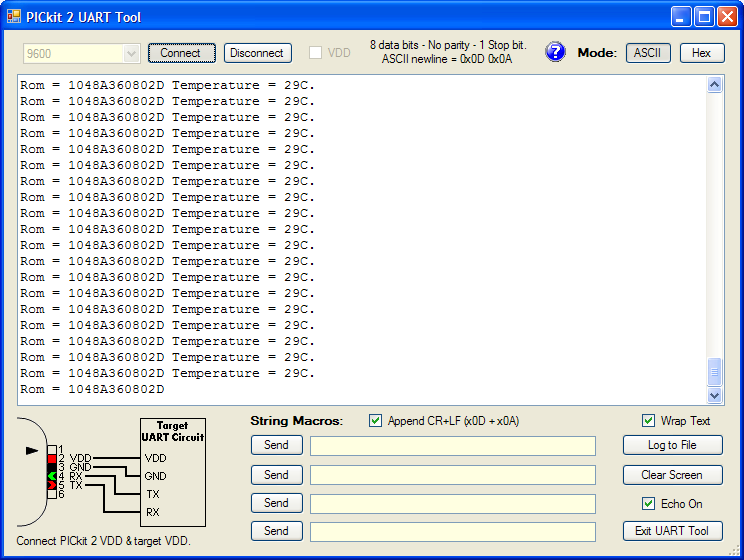

Once the code is running you can use the UART tool in the stand alone PK2 software to see the attached.
Good to hear it's working. I'll bet it doesn't say 29C on your screen.
