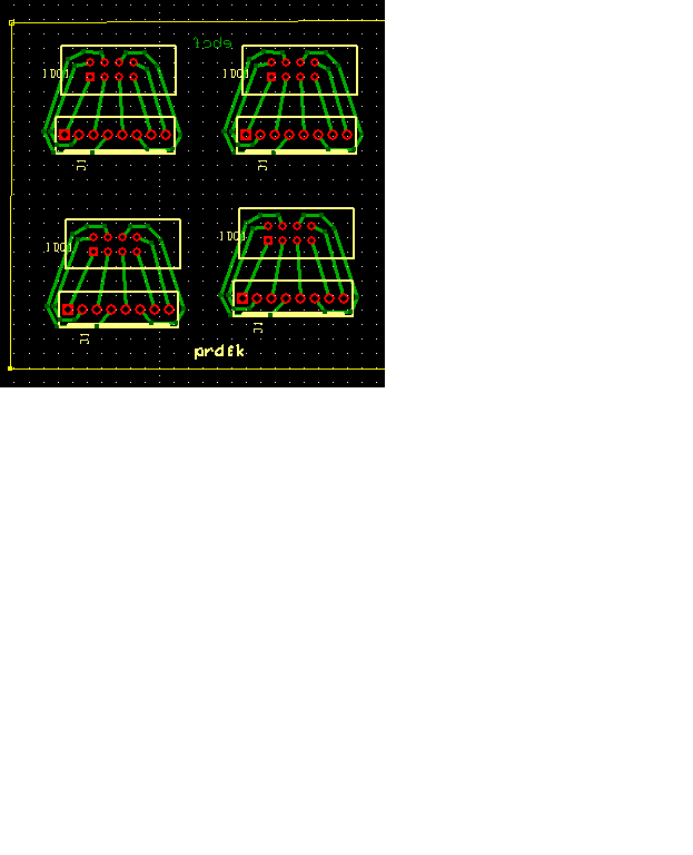

pc boards 4 icd and con2
pretty sure its con2 = 8 pin plug on Junebug for connecting to off board (Junebug) stuff. this way you can connect say a circuit and test using the buttons etc on the Junebug.
pc boards just made it simpler.
Purchased plugs etc from Digi-Key.I built 2 sets.
You need to use the ribbon cable from the Junebug or get some from an old computer (thats what I did.keep the lengths 6" or less.
The pc boards are very simple. If you want the expresspcb file then just ask
1 4 S5444-ND CONN FEMALE 8POS .100" R/A TIN 0 0.83000 $3.32
2 4 S5519-ND CONN FEMALE 10POS DL .1" R/A TIN 0 1.00000 $4.00
3 4 609-1746-ND CONN SOCKET IDC 10POS DUAL 30AU 0 1.21000 $4.84
4 4 609-3083-ND CONN 8POS .1"X.1" IDC RIBBON PCB 0 1.02000 $4.08
