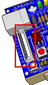

Dear All,
For some strange reason I am having a hard time trying to find a connector for my JuneBug (See attached).
Can anyone help?
Thanks in advance
Mark

Use a standard 'open' 0.1inch pitch 8 way Molex male pcb mount.
The mating part ie: the cable socket requires crimp wire tags as well as the header.
Look here:
https://uk.farnell.com/jsp/search/productdetail.jsp?sku=9730982

I'd use what you can find, the KK type are available from digikey.
Here's the 8pin KK PCB connector
Digikey #
WM4207-ND for the header
WM2006-ND for the cable part.
WM1114-ND for the crimp terminals.
digikey page with connectors, headers and contacts.

I just use plain old single row pin header **broken link removed**. Simple, cheap and versatile. If your parts bins don't have a bunch of these already, they should have. They come in **broken link removed**. Simply cut off what you need.
You can buy matching **broken link removed** as well. To make connectors to plug onto the male header I use **broken link removed**. Here they are **broken link removed**. You can also use female header to make connectors.
I made a **broken link removed** to connect the Junebug's **broken link removed** to a breadboard. Here's the **broken link removed**. And here's the **broken link removed**. As you can see, the way I built the breadboard end isn't the most robust connection in the world. Some hot-melt glue would make it somewhat more permanent. It's quick and dirty - **broken link removed** for now. :D
