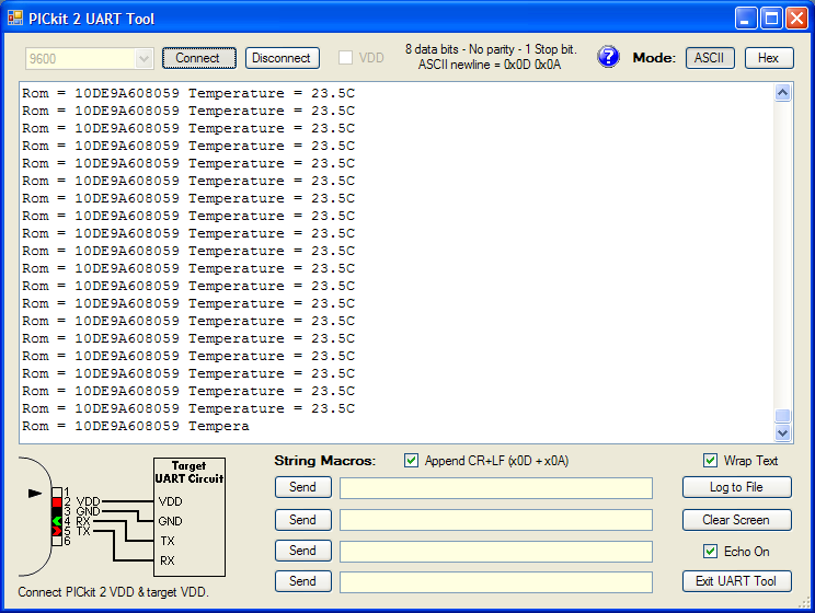

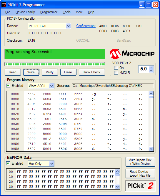

The code I posted should just work. The steps to get it to work are,
1. Place a DS18B20 into con4 on the junebug with the flat side facing the USB socket.
2. Compile the above code in Swordfish.
3. Use the PICkit2 programming software to program the Junebug after loading the hex file. See first attachment.
4. Select Menu Tools->UART Tool and click connect. See second attachment.
Edit, forgot one thing, for this to work, Junebug switches 1 to 4 need to be switched on. These are Tutor and TX.

I get the same temperature reguardless of applying a finger or ? to sensor body.
Looking at the code you posted (only code I could get that actually worked and displayed ROMid)
I see where the math dosn't make any real sense? and it "looks like" the code only gets the sensor temp only one time?

Ahh ha, just realized the problem. My bad, I am using a DS18S20.
Try this code,
