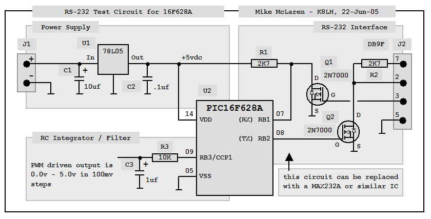

I've looked and looked and can't find anything that seems to do what I am trying to do. I'm trying to look for a way to fade/pulse an LED. Many many people suggested using PWM and a micro. That's what initially got me interested in learning about them - however I can't find a single example to pulse/fade using PWM and I am completely lost.

agent420 > The concept of PWM isn't confusing, but some of the basic implementation within a pic and dynamically ajusting it. I just can't find any clear assembly examples (which isn't surprising considering my knowledge level at this point)
Mike > The 16f628A if I can get away with it
I've got a Demo for 16F628A running at 20-MHz. It uses RS232 and Hyperterminal "front end" using the "<" and ">" keys to adjust PWM duty cycle which is measured as a voltage between 0.0 and 5.0 volts in 100-mv steps from an RC integrator on the CCP1 pin. Will this help?

If you study and understand the code you should be able to;
(1) change the InitPWM code for a different oscillator/clock if necessary.
(2) replace the RC Integrator circuit on the RB3/CCP1 pin with your LED and resistor to VSS (ground).
(3) remove all the RS232 serial code (Init232, Put232, Get232, _Title macro, PutString, etc.).
(4) replace the serial "<" and ">" code in the LOOP routine with code to test switch press and release operations.
Several of us can help if you get stuck.
Have fun. Mike
