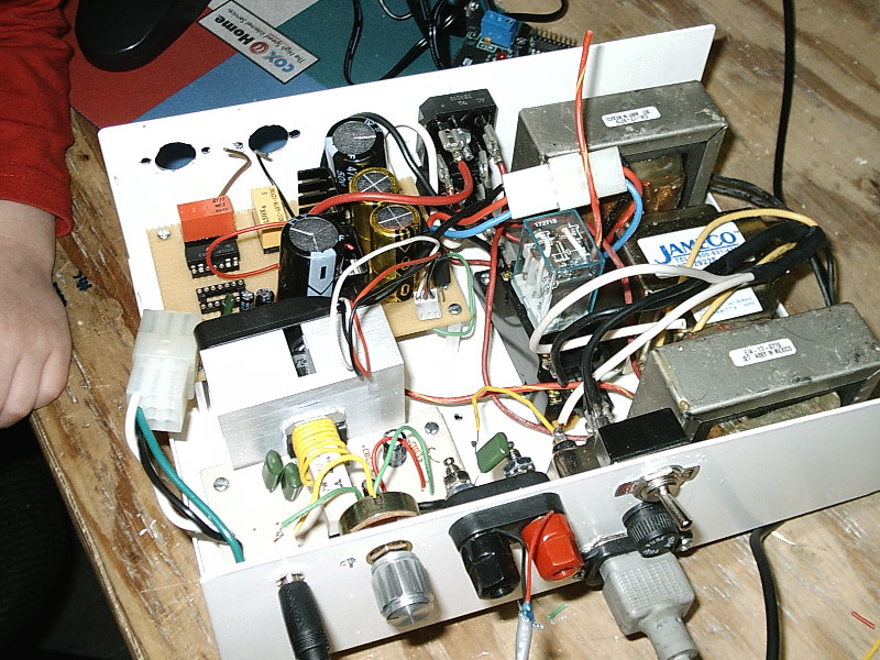

iv'e got a problem now. when i take the scope lead off of the output the sound goes away and all i get is a loud hum. i can put a single lead on the negative but if i put a single lead on the positive side it almost blew my brain out of my skull. it sounded like an extremely loud pop..pop..pop.............. any ideas as to what could be causing this?

Can you take a picture of how it's assembled?.
How far away are C5 and C6?.
BTW, I would suggest you place C5 and C6 where they should be, close to the chip, they aren't really the main smoothers.
i can take a pic this evening when i get home. so you think c5 and six could be the problem? i didn't have any caps that could take the voltage. i might have to pull one off of a scrap board if i can find one. what time is it in england right now. im at american central time and it 10:40am. is it nightime over there?

chipamp.jpg here is a pic
