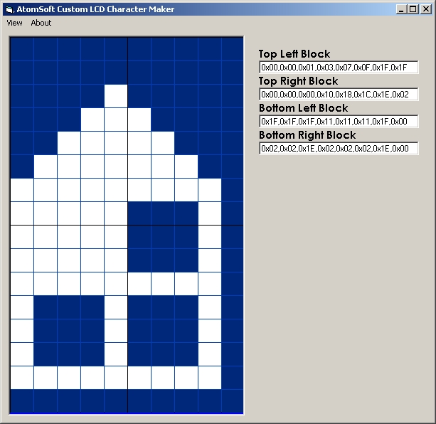

Hey since i just understood making a custom character for lcds and i havent seen this around i though id make a nice tool in vb that generates all hex , dec or binary codes you will need to define a custom character.
Here is a pic and the actual file. (you will need vb6 runtime files installed)

How does it work? I downloaded it and it doesnt want to do anything. When I click on the screen it exits out.
oops forgot something thanks.
EDIT: If you already downloaded it just download the fix and place in the same dir else download the full one.

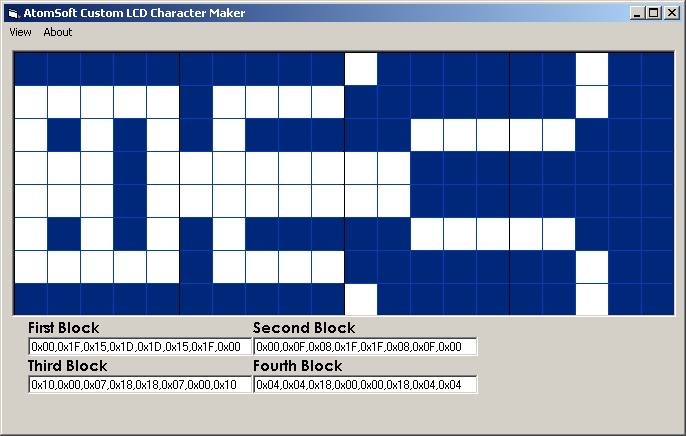

And im making another version right now with 4 blocks.

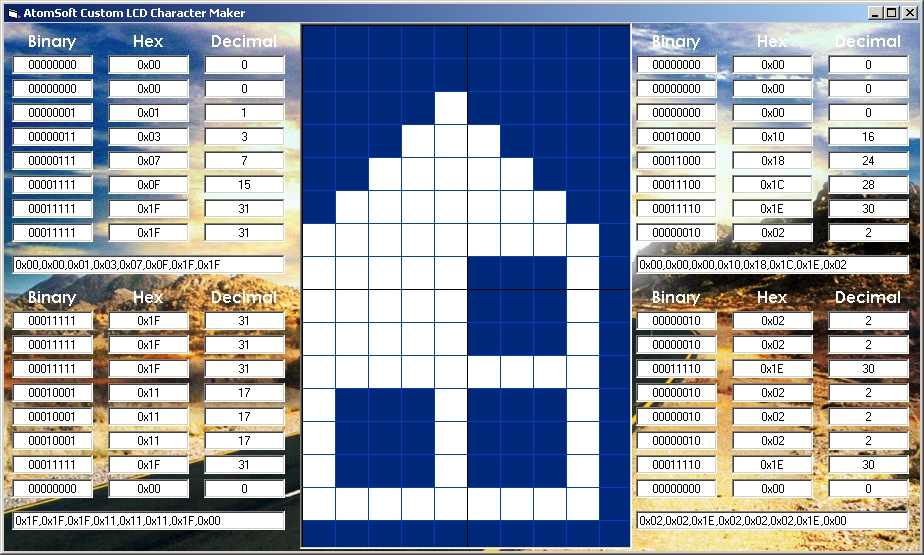

a pic and the files to go with it. Discard the old one (unless you want a large single view)
Hope you all like this one i might make 1 with 8 in the future for larger designs!

What is that hideous background photo? IMHO a single color background would be a lot less distracting. Looks like a good tool, but I'll never use it. Getting there is ALL the fun for me. :D
It is easy enough to change the background if you want to.
Maybe do the multidigit versions like this.
