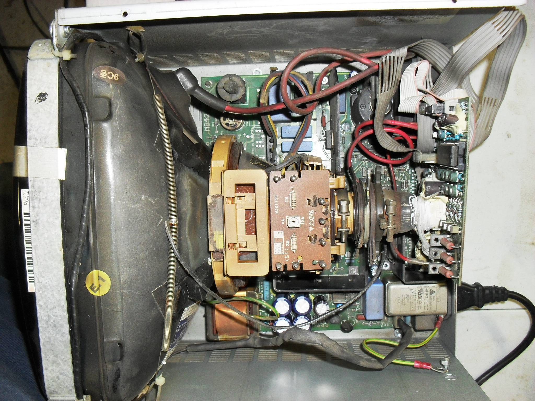

Repaired an industrial color CRT. Monitor would not show any image. Replaced a pile of capacitors and resoldered the big transformer (flyback?), and the incoming 120VAC power supply terminals.

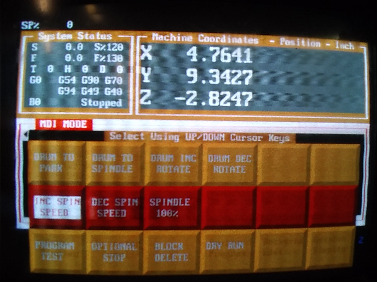

CRT powers up normally, sounds good, image quality otherwise is much better than it was. Brighter anyway. However there are some shadows and vertical lines that are more visible on the left side of the screen and fade towards the right. Also, any vertical lines on the outsides seem to oscillate from wavy to straight sort of at random.
I tend to think this is interference induced from having certain wiring touching each other but figured it was worth asking first. That high voltage wire is what I am looking mostly at.

It does look like some cross talk is occurring.
It also looks very dusty (dirty) inside. Try cleaning up all the static dust. Then try to arrange the various (especially the high voltage) wires and ribbon cables such that they are as far as possible from each other and running as close to perpendicular to each other as is practical.

The vertical lines seem to be present most of the time I think but the wavy vertical edges seem to be wavy for a while, then straight for a while, at random. The ghosting to the right of characters seems to be consistent.

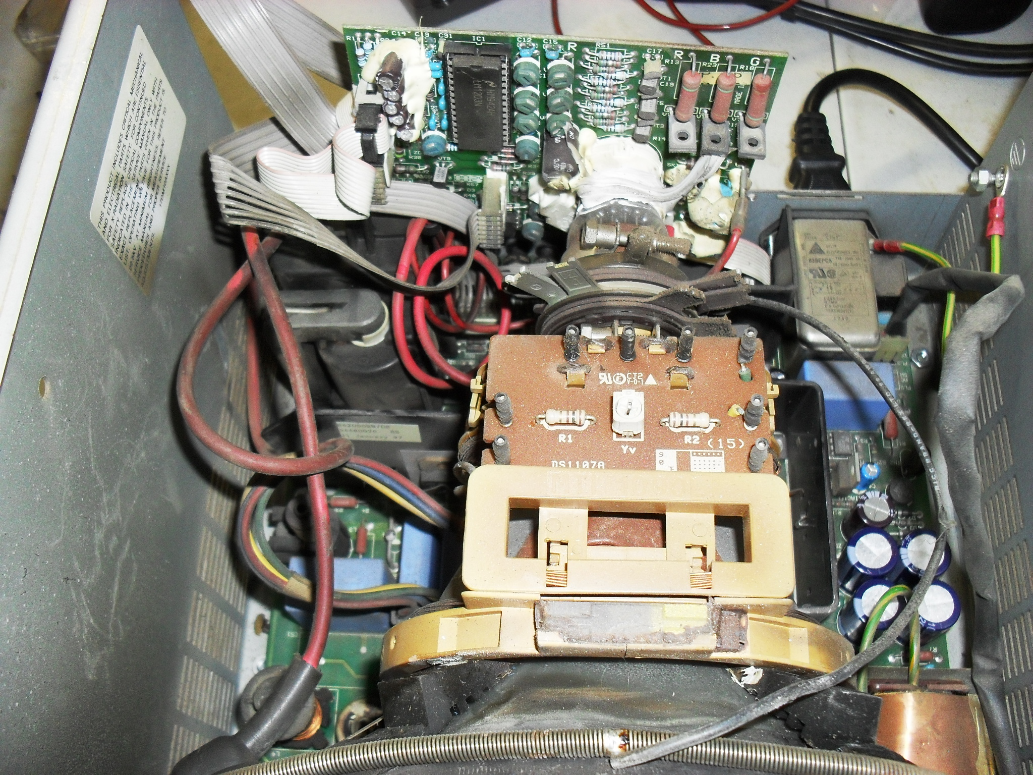

I would suggest scoping the supply lines, particularly those fed off the LOPTX - there's probably a high voltage electrolytic on the CRT base which often gives problems.
Excuse me for being nosey Nige, but would that be to do with the screen voltage, or one of the other grids?
The HT rail for the video output transistors (around 200V or so), the reservoir capacitor for it is often on the CRT base and thus easily overlooked - so it's actually for the cathodes.

When I first looked at this I thought the grounds were not connected on the video cable. Look at "X Y and Z". See the ringing. It looks like the video is repeated 5 times. Left side third line. "T0H0D0" Seems to have a ring or oscillation. On the right side the "7" repeats and repeats. Could be the video board is not grounded to the main board well. This long a ring and delay looks like a long ungrounded video cable.
I think this monitor also has yoke ring or linearity coil ring or maybe damper diode ringing. It probably has all ways had that.
There is text on the bottom right buttons. Must a burned CRT.
I noticed "System Status" has no ring but "T 0 H 0 D 0" has great ring. That said; the problem, as seen on a scope, will have noise at 20 to 50 times the horizontal rate. It should be easy to find. The noise is related to white text on black and not white on brown. The black/white is where all three video amplifier are working hard. So this points to noise on the video amplifier's power supply. (Nigel)
So video coax grounding AND bad capacitors.

To add to this. I have connected 2 different LCDs, both have a clean image without distortion. As mentioned in the other post, I replaced all electrolytic caps on the main board. I did not, however, even think to look at the base board on the end of the CRT tube.

Yes I get that, if you recall a while back I built the xy monitor from a 14" telly, originally it had a driver ic for each cathode, and I seem to remember that each of the 3 ic's had its own decoupling electrolytic, didnt later telly's have one ic with 3 amps inside?, they look like a wideband high voltage op amp with low z o/p stages to drive the capacitance of the cathode.
Most people don't think to look there :D
