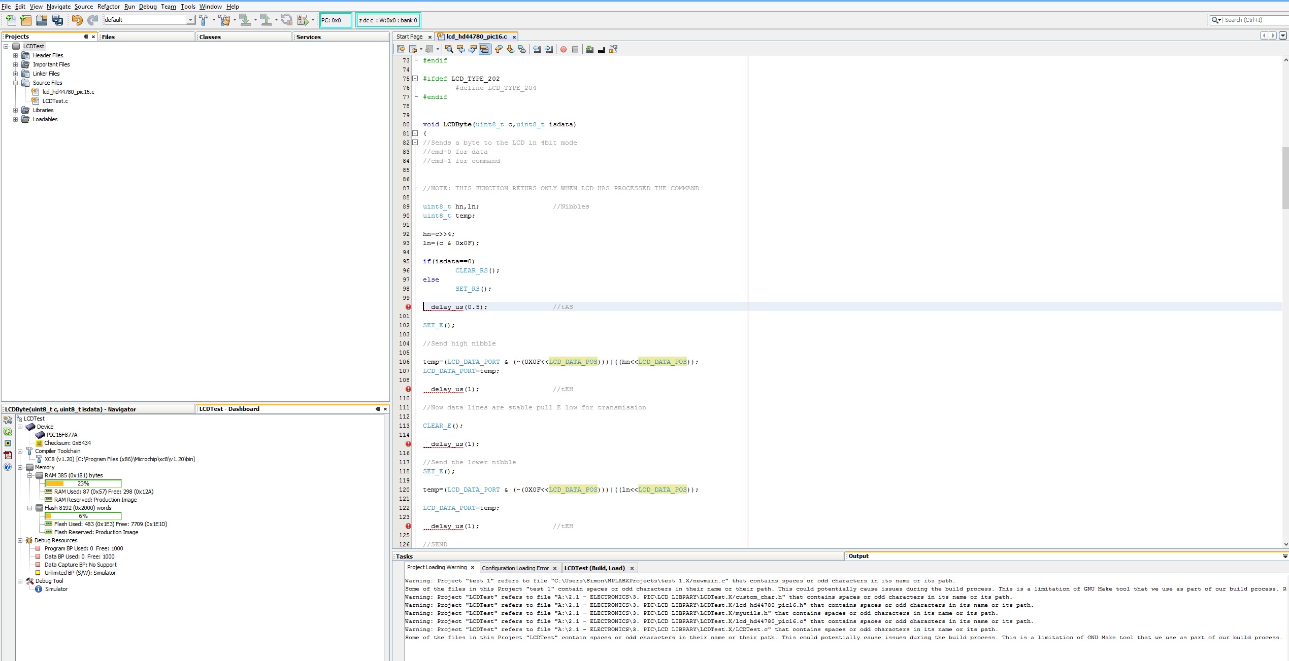

OK I have just downloaded MPLAB XC and have loaded a couple of examples I have found (for this version) and in all cases I get an error on
__delay_us(....);
It says "Unable to resolve identifier".
I built it and it built.
I checked in this project in properties and then compiler to see if Define Macros had:
_XTAL_FREQ=20000000
and it does.
It is probably a global setting I dont know about however I have included both a screen dump and the zip of the program.

"Unable to resolve identifier" is a linker error. Linker is a program that takes all the compiled pieces of code and "mashes" it into one single piece of code that includes all the needed functions etc. It needs to resolve all function calls so that they work properly and that all functions are placed correctly in memory so that they can be called correctly. The problem you are having is that the linker can not find the __delay_us() function anywhere. I have not used MPLAB XC, but there must be a setting somewhere (Linker Files.. maybe) that you can include the correct library to the project so that the linker can find it.
Sooo... I found that if I actually included #define __delay_ms(x) and/or #define __delay_us(x) depending on which one or both I am using it ceases giving an error... finickity? one wonders why this isnt an automatic thing as pic.h should automatically be used by the parser....
I'm not sure what you did to get rid of the error.. Did you define the __delay_ms(x) macro yourself by adding this line to your code:
If you did that, then you re-defined the macro to do nothing. It gets rid of the error, but you are only replacing the original delay call with "nothing".
You need to include the macro
_XTAL_FREQ=20000000
In the LCD C file OR before you define it in your main file.. either way before you call a delay function.... BTW I don't think you can use a float in the delay arguments..

The program will run, but the delay will not work because you replaced the original __delay_ms(x) with empty definition. (If you did write the line "#define __delay_ms(x)")
You need to include the correct library when you are using functions that are part of the library that comes with the compiler or Integrated Development Environment (IDE) (MPLAB XC).
