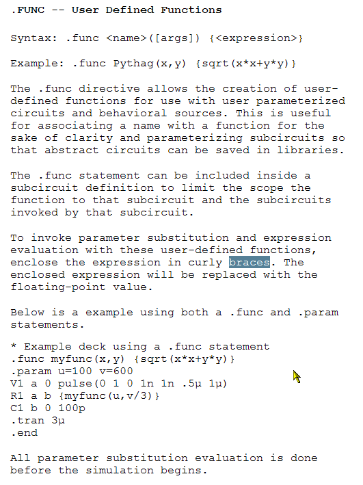

LTspice shows errors suggesting it's not complete, and I'm sure it isn't, the model in the PDF probably has to translate somehow to lines in a .sub file that include that net list and begin with a .subckt line defining a name and the main nodes/pins it has. There also seem to be some odd brackets in that netlist. I copied it VERY carefully but it looks like LTspice isn't having any...

Do you mean the {} ' braces.?
These braces are important in the expression for parameter substitution.
Look at this extract from the LTS Help files,, Search braces

Hmm.... 'braces'.. At least I now know how to look them up. :) No, not working yet though. I think the braces are purely to allow the multiplication operator * (as explained in a second page that braces relates to in the CHM file). but the netlist isn't enough of a .sub file to make LTspice happy. There's a whole load of undefined variables in there that are presumably defined in the circuit shown in that PDF (halfway through file, it contains other short articles).
