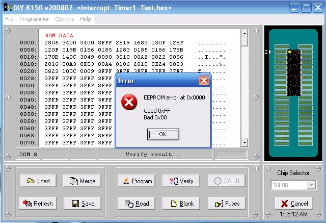

I'm programming a 16F88 PIC and suddenly it comes up with an error (see attached).
I didn't change any settings. I'm using the same pic, same programmer as always. No problems with it till now.
The programmer's a K150 (Kits-R-Us). When I load the software (microburn) it says the board is connected. I try erasing the chip but the programmer can't recognise it as a 16F88...then I try programming the chip and it comes up with errors.
Tried two different chips with the same result... what a bugger.
Clues??
Ta -Tom

Ok I've narrowed the problem down... It's not the programmer (at least I think not).
I grabbed another 16F88 PIC (new). It seemed to erase fine. I then loaded it with a different program. Seemed to load fine too.
So it's occurred to me that my program is killing my PICs! It's basically started happening when I started playing around with the Timer1 function. essentially, the program should turn an LED on, wait until Timer1 overflow interrupt occurs, then turn it off. Think it might be something to do with the T1CON Reg set up... Here's the code:

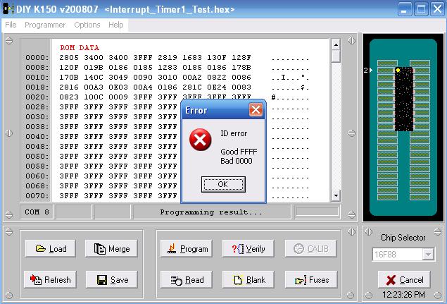

Hi BeeBop, I've programmed these chips before with both internal osc. and MCLR off. So far I've never had any dramas using both functions. It's only when I've started playing with the Timer1 register that I had problems. These functions could be linked though, I'll check the datasheet when I get time...
To erase the problematic chips, I've tried to do a "blank" for each one. That's when the errors come up. How do I do a bulk erase? or is that the same thing? Doesn't look like there's any function for a bulk erase in MicroPro. Unless it's an erase using just hardware?

Found the culprit. It was the T1CON Resgister set up:
movlw b'01001001'
movwf T1CON
This made the PIC try and run off Timer1 Oscillator, even though it was set to IntRC osc. bad bad bad. Instead set bit "0" in the T1CON Reg (see code).
