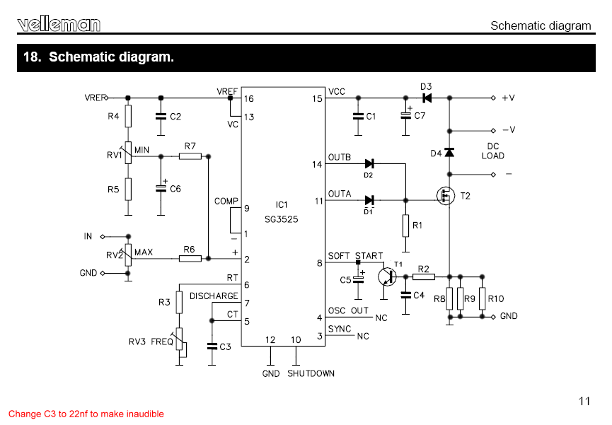

I use velleman K8004 PWM controller card to drive DC motor.
DC TO PULSE WIDTH MODULATOR
Manual:
https://www.electro-tech-online.com/custompdfs/2010/08/illustrated_assembly_manual_k8004_rev3.pdf
I have Canon Printer Carriage Motor QK1-1500
TN425813 12V DC.
I control the motor via 1K pot. I use internal reference voltage to control the motor speed. But as the load changes so does the motor speed.
How can I adjust the speed like I do now via POT but be able to lock it?
Please see manual page 8 for connection options.

When I adjust the resistor on K8004 PWM kit (configuration C internal reference voltage 1K POT) the voltage on motor changes.
At start there is 0V then 8.4V at Max speed. This is the same for forward and back spin direction.
To change the spin direction I use 3 position switch on K8004 PWM kit that just changes wire polarity connecting the kit to PSU.
The voltage on the 1K pot changes too, at start there is 0V - at Max speed 4.8V

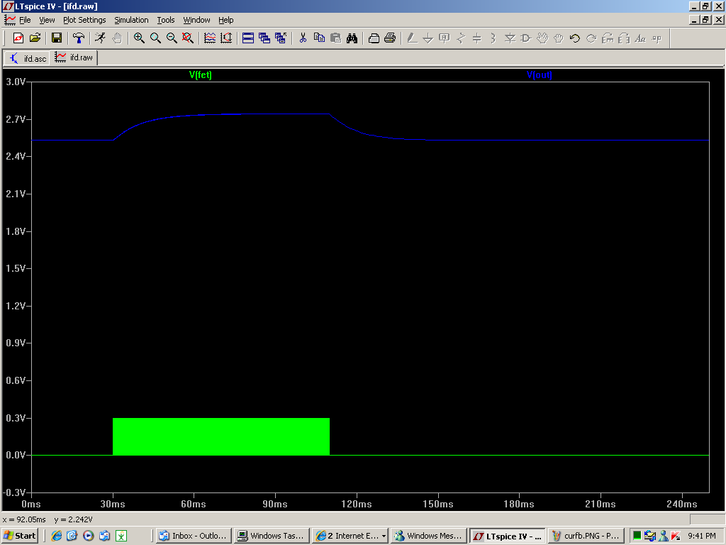

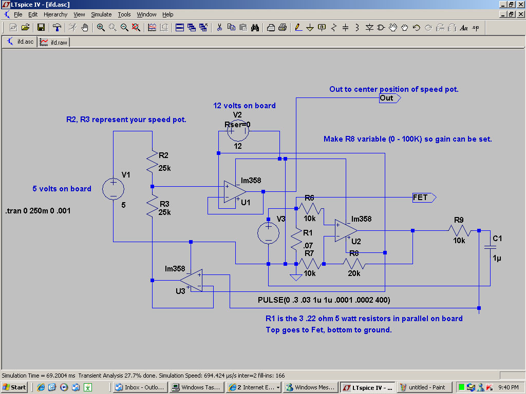

Well, I'm no servo engineer but no one else stepped up so here is something I think will work for you. This is current feedback as opposed to velocity feedback but the result should be stable speed with varied load. It measures current which will increase under load and increases the motor drive to compensate for the voltage drop of the motor.
You should be able to tap into your controllers +5 and +12 and ground to power it. Make sure the frequency pot is set to 5KHZ. There are 3 .22 ohm 5 watt resistors already on your board for current sense. One end of these goes to ground the other end to the FET. Put R6 to the FET side and R7 to the ground side. R2 and R3 represent a pot in the schematic with the wiper set to the midpoint. I just did this for the simulation. Any value between 10 and 50K is ok. I would leave the pot on your board until testing is complete, but ultimately the output of U1 goes to where the wiper of your speed control pot goes now. R8 should be a 100K pot. With this you can set the gain of the circuit to match the motor. Start with it set at about 20K or less. To test it set your speed pot to 2.5 volts and the pot for the new circuit at 2.5 volts. The output should be just slightly higher than 2.5 volts. If you apply a load to the motor (say with your finger) the output voltage should rise slightly (like the simulation). If you get to this point you can remove the pot from the controller and place the output of the circuit where the wiper was. Adjust R8 for best response to load change without oscillation.

that would be IR compensation (current*resistance)
i have gone this so MANY TIMES! IR compensation prevents most of the slow down under load. motor voltage is proportional to speed, luckily motor voltage is also proportional to supply voltage and duty cycle so you can control duty cycle with speed command, IR, and supply voltage. this gives you decent control but not the absolute accuracy of speed feedback.

Well I changed the frequency to inaudible range by forum member help. C3 was changed to 22nf. I have no means of measuring the exact frequency.

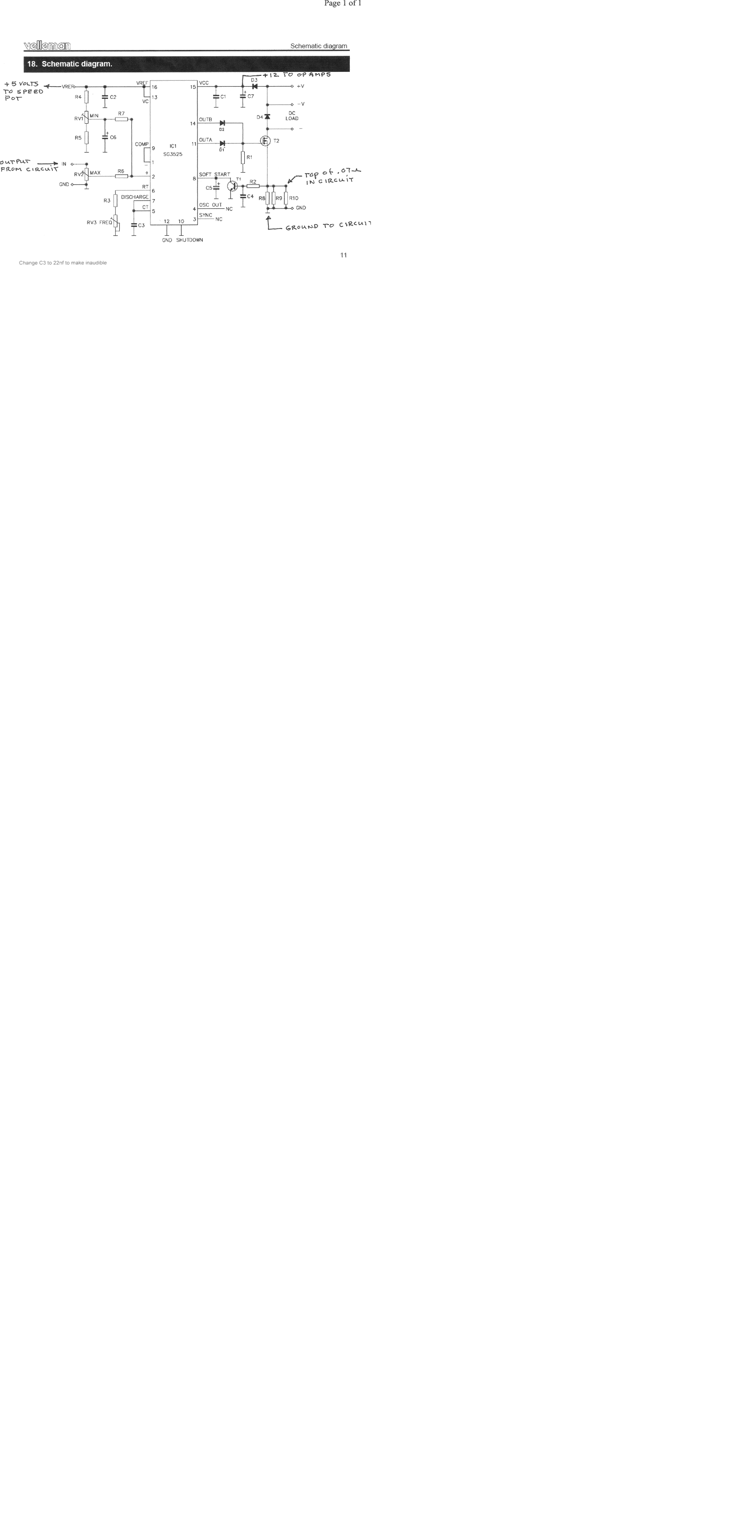

Could you draw the required modifications on my attached circuit? I'm afraid I'm having difficulty following you :o I can't simulate this as parts are missing from my simulator and don't wan to damage already working PWM controller.

The speed will be controlled by sensing the current thru the motor. The current goes up when the load goes up(motor slows down) The circuit will speed it back up.

I worry about this as well but if you decide to build the circuit maybe we can test it before you hook it up. Here is where the wires go.

add opamp gain to R8 signal, peak detect, resistor to IC pin 2 (it is a summing junction)
increase feedback slowly until it works well enough - to much and it will run away to full speed as this is positive feedback!
