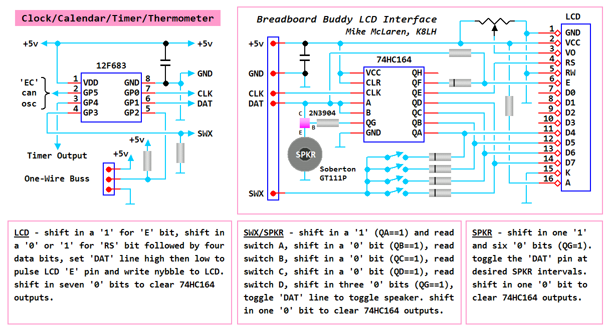

Just wanted to pass along an untested idea for adding functionality to the original Myke Predko 2-pin LCD Interface design. Constructive criticism and comments are welcome.
I'm trying to come up with a relatviely simple LCD+Buttons+Speaker device with a 2 or 3 pin interface to provide the basic functions I need when I use low pin count PIC devices on a breadboard. This would actually become the third device in a series of hobby "Breadboard Buddy" products I'm developing.
I hope to test the first circuit soon (below). If I can get that working then I think I would like to try connecting the SWX pin (switch matrix output) through a resistor to the 'DAT' pin and try to get all the same functionality with just a 2 pin 'DAT'/'CLK' interface.
I will pass along sample Assembler and BoostC routines in a subsequent post.
Kind regards, Mike

Hi Gayan,
I included the 12F683 in the drawing just to show how even a small 8 pin PIC can do something significant when some basic functions (LCD, keypad, speaker) are available through that simple Predko interface.
BTW, those latched output lines could be used to drive the columns (or rows) on a 3x4 or a 4x4 keypad too but that would require 3 or 4 input pins on the PIC.

Thought I'd post a sample subroutine for reading the switches and generating a "new press" beep. The DAT, CLK, and SWX pin defines are implied. The subroutine returns with switch A = swflags.0, switch B = swflags.1, etc..

Why don't you just replace the logic chip with a small PIC, then you can make a standard protocol interface, like UART or I2C? It seems like an overly complicated interface when you could make the target 'smart' and handle everything including LCD functions on the peripherals side. Basically a serial LCD controller with buzzer and buttons.
This 74HC164 design just has a nice bang/buck ratio.
Really? How much would a PIC cost that you could offload these functions to? I don't work with PIC's, but I'm guessing $3 max. It doesn't seem like cost savings justifies the extra complexity and more work required by the master device.
Mark, you're probably right. Not that much more cost to go right to a PIC to provide a lot more capabilities. I still think it's kind of cool adding functionality to this simple 38 cent 74HC164 interface though.
Mike
I said all that, but I realize cost to functionality is not the same for a hobby project. I've done things the hard way plenty of times just because it's more interesting to do so.
That right you take the fun out of doing it the easy way. And getting a lot out of a 12f683 is always fun.
Pushing things further... you still have QH to play with. What if QH combined with the DAT (as done with the speaker) was used to disable/turn off the backlight?
That way you could appear to put the display to "sleep" (if desired).
Note the reverse logic however... which may not work if we have to continue to scan the keys while "asleep". (Though you may effectively get a PWM effect on the backlight, so "dim" vs "off"). Anyhow.. something to think about.

felis,
That's a very nice write up. You could easily modify the design to add a speaker and to use the latched outputs as column or row driver lines for a keypad.
Kind regards, Mike
