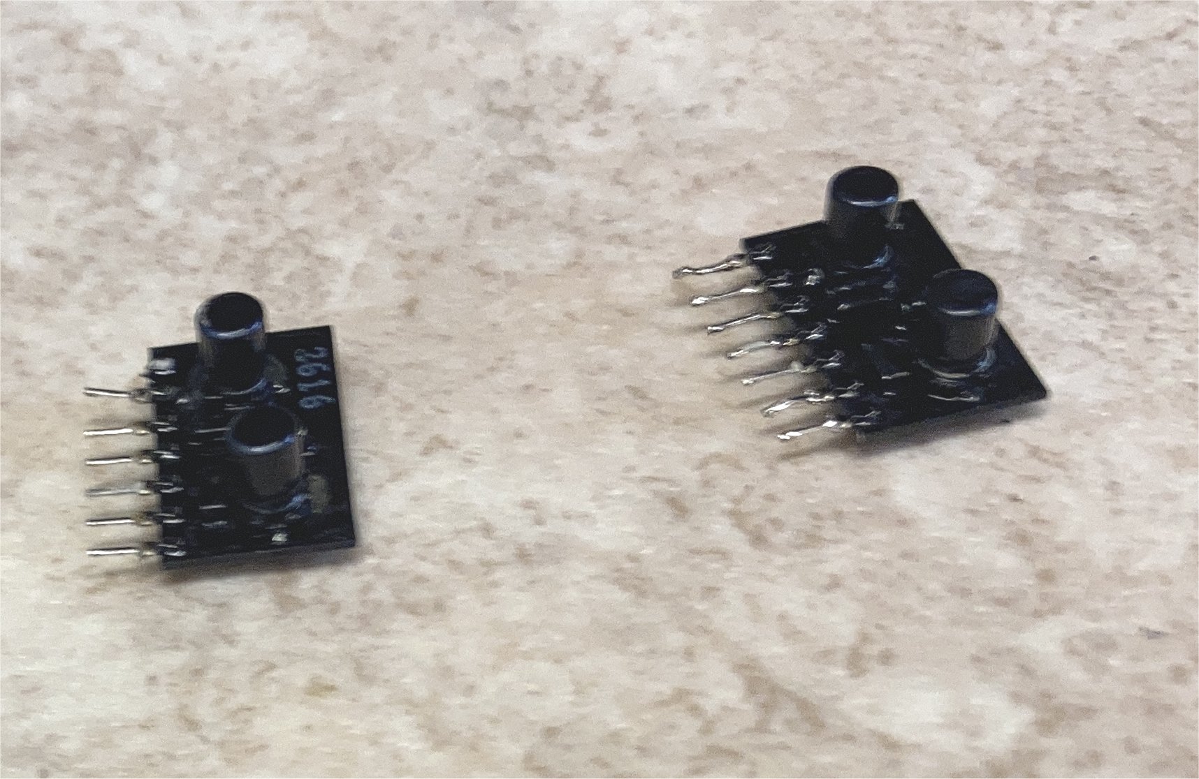

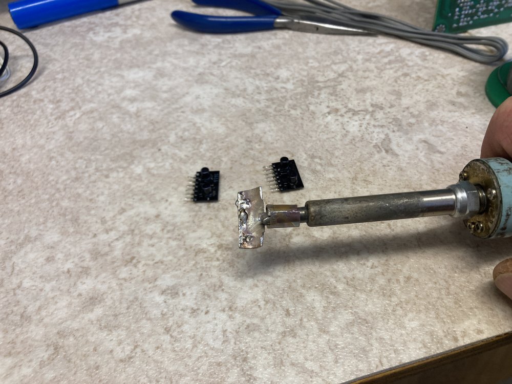

Removing the two non-working HIC modules was quite easy. But I needed to make a tool for removing the 7-pin modules from the PCB. The pins of the module were quite tight in the PTHs, and a solder pump wasn't removing enough solder. I needed to make something that would heat all the pins at once.

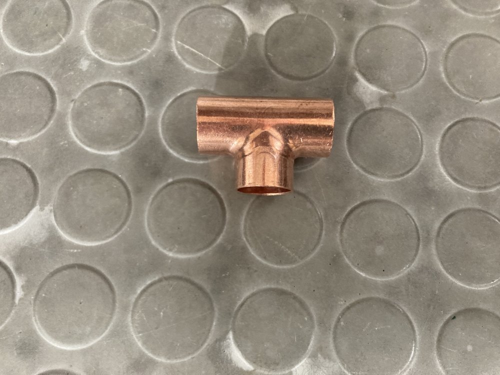

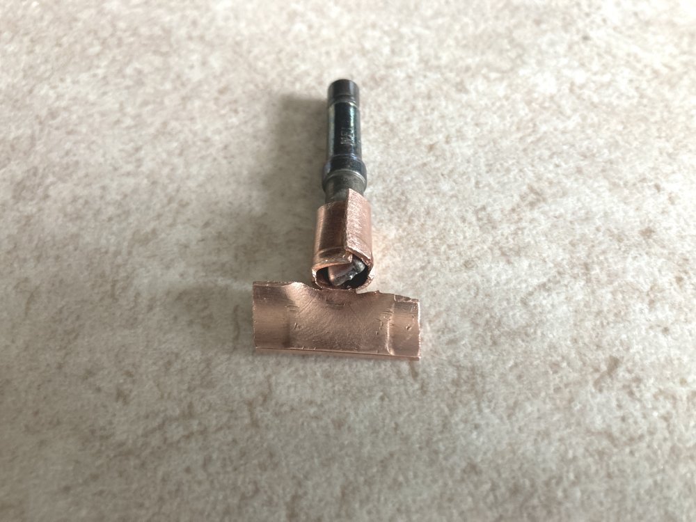

I started with a 15 mm copper T piece from my plumbing spares, which I modified using a hacksaw and file so that it would fit on my large 700 degree Weller soldering iron bit. Removal of the two HIC modules was an easy task using this home made de-soldering tool!

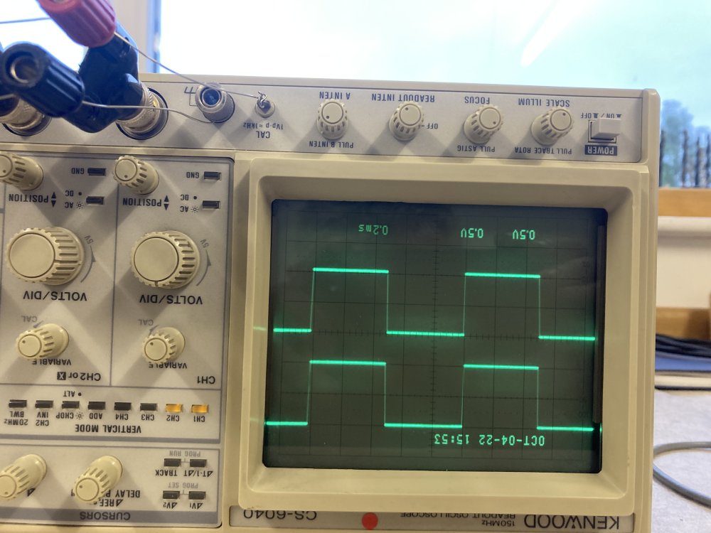

I then replaced the PCB and was delighted that the correct vertical gain had been restored to Channel 2! And Channel 1, which would occasionally flicker, was now stable.
It's clear that the HIC attenuator modules really let down an otherwise superb 'scope. Removing them at the first sign of trouble is probably the best thing to do. Happily, most tasks do not require variable vertical gain.

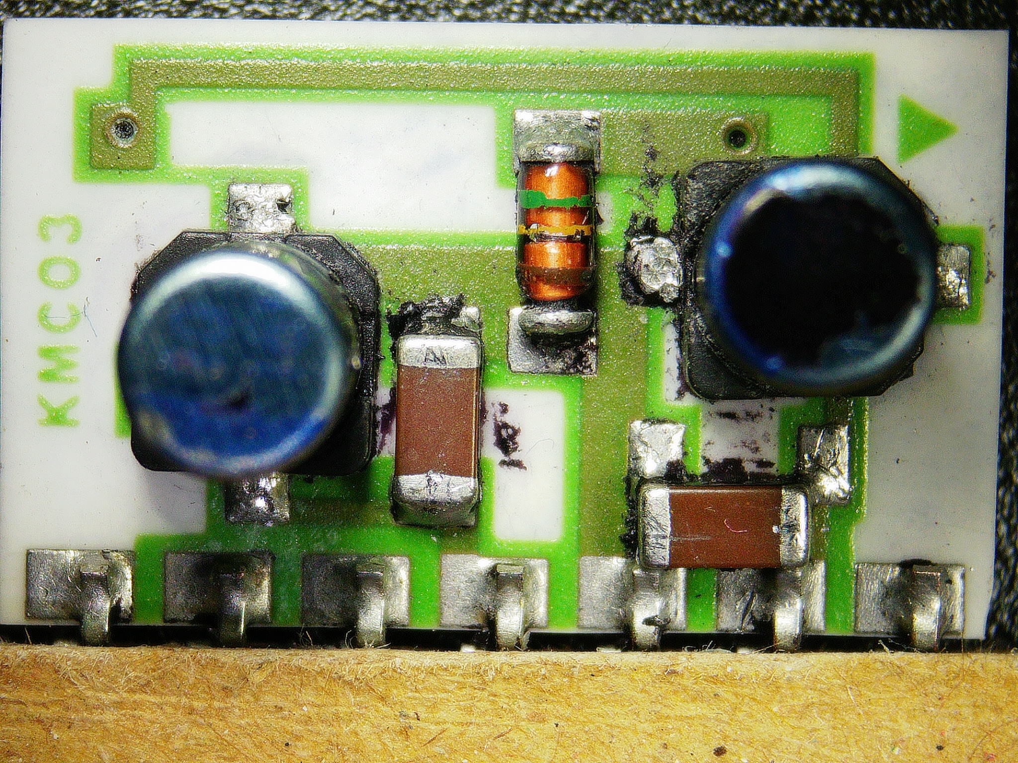

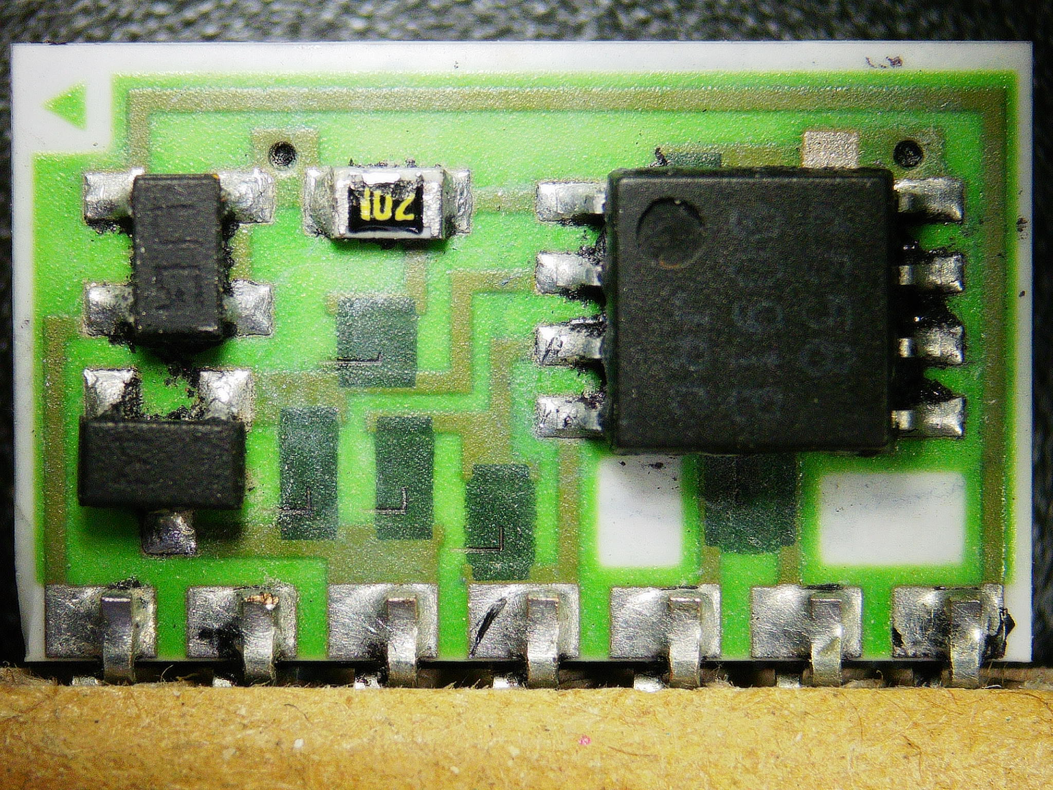

Thanks much for posting this info about the 6040 vertical attenuation issue. I got a 6040 and it had the same issue on ch1, so I bought a cheap 6030 hoping it would have part HIC to swap out. The 6030 (100Mhz) came in excellent cosmetic condition and it actually worked fine, so decided to swap the entire board into the 6040 and it did seem to work fine. However, the board number had suffix 00 inked out and replaced with 01 so not sure if it was identical. So off to Ebay and got another 6040 dirt cheap and sure enough it had the same attenuation problem on ch1. So took the one good HIC from that and put in into the other 6040 and now it works OK. Ended up with a good 6040 , a good 6030 , and a 6040 with both CH1 and 2 without variable vertical.
Now have 2 bad HIC out of circuit to try to get the film off to figure out what it is. Maybe one of the 2 capacitors on it are bad, if that is what they are. May be some leakage at the bottom of them, not sure. Might be possible to replace them. I have depoted some other devices using boiling water but those were in solid chunks of epoxy that could be gouged out after it got soft. Did I read you used acetone to read a part number on the HIC?
Thanks again for taking the time to post this, without it I would have been stumped.
Here are pics of both sides of the HIC U102 KMC03 board, looks like a dual op amp jrc4558(LM741), a three terminal and a 4 terminal device both with no real markings. Since components are on both sides drawing out a schematic is a little harder. Just in case anyone has any info how to help identify the 3 and 4 terminal devices, or what they most likely are. Thanks to all.
