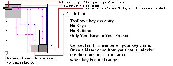

I have a concept for a nobless door on a car...The handle is gone...
leaving a keyless door with no handles....
Ok i want to go about this easy enought with rf transmitters and recivers...
I have a shematic of what i want, but i am only basic at electronics....
I want the door to pop open with a motor when i walk within 2 meters of the car/or swipe a rf key on the door where the lock used to be.
this is it keyless entry and a pop open door...
is it posible? i want to make the whole thing my self and learn along the way..
this is for a project/show car, it is for looks but i still have to open the doors...
The inside of the car will still have an attachment to open the door from the inside... for safty resons and a pike stick to shatter the window in the even of emergancy....
I dont know where to start looking for papers on the rf control or how to control the motors with rf...
i was reading up on this https://jap.hu/electronic/codec.html can someone help out? and point me in the right directions. or have a paper on how to do it already?
Thank you for your time in reading this... TasDawg

Wellll... My solution isn't a complete DIY...
Having said that, you could purchase an RFID kit from Altronics
https://www.altronics.com.au/index.asp?area=item&id=K9300
A solenoid to unlatch the door lock - from jaycar
Followed by a door opener (found by 'googling')
https://www.privatedoor.com/
From the RFID kit, you would need to send the output signal to a circuit which will which will power the door solenoid for 1-2s while the door opener gets going then you can remove power from the solenoid. Then via a push button on the dash the door would close?
Any other suggestions anyone?
Edit: If you want to UNlock the door as well, you'll need one of these too

One solenoid I suggested is to unlock the door, and the other one is to unlatch the little lip from the U bolt in order to open the door. Both products have the power to do this, as that is what they are being sold for. So you don't need a 'motor' as such...
Hmmm, that's when you install ultrasonic sensors in the side of the door to detect any obstacles. *rolls eyes* - This is getting more complicated.

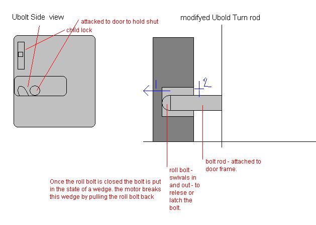

It will be used in the real world as well - i have had time to think a project managment of safty(outside assistance) - risk(hitting someone, the shopping mall), the 2 meter range, pop-open and so on... here are the assesments.
safty - the RFID Entry Tag will be connected to the airbag sensor circuits.
- for the added safty the glass on the drivers side will be safty shatter glass with rubber seal(easy to break into(alarm and security is not a problem the car is fitted with motion detection), this will alow for in a crash the window to break off, the door to pop open(not swing).
risk - the RFID Entry Tag will be connected to a pop open - thius meaning sorry but i want the door to pop into the U bolt, the ubolt will be modifyed by safty regulations to lock and unlock with a twisted rod instead of a latch rod(diagram added), having this said the risk of having a 2 year old or a car being hit by the open door, is not posible beacuse the cars door will not move any more distance then the ubolt(your thinking its still the same as using the door handle, but say you have a hand full and cannot put it down(money bag with $50,000) your not about to sit it on your roof, the gapfrom the door will be about 4 inch's and still connected to the ubolt turn rod).
the RFID Entry Tag will not be set at a 2 meter range, it will be set at 30 - 40 centermeters
Thank you so much too everyone :) - you can over look my concept to inprove the design - i will credit your names at the car show, this is going on all four doors(different channels, so if u walk past the back door to the front the back door will open but once you are at the front door and open it, i want the back door to close. i also want this for the bonnet of my car, i would like ot have 3 RFID Entry Tag keys on my keychain(added security - bonnet/boot, front doors/back doors) altho this will be going on a GTR Skyline i do not see the point for back doors lol.....
And i have been looking at butterfly doors, and adding this concept toward this, for added security, risk assesment....
Please keep the sugestions coming, i am off to buy the parts left in the first post by erosennin - i live in qld maybe a trip to auto salon this year to see ur handy work erosennin?? :p
