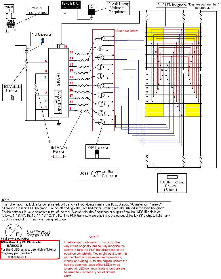

Hi, I've attached a diagram I found of KITT's voice box, it has a audio input but no output. One could be added easily though. I tried it and it works great.
Have Fun!!

Hi, thanks for the diagram, I find STARTUP diagram like Knight Rider, microphone in for KITT's voice box, You can helpme? please...

Yes, you are correct, I was the person who built the KITT voice box and placed it on You Tube. My real name is Shane Hunter, I put that diagram of the voice box on this site before I modified it to my needs, I hope you like my voice box and now I have just finished it off and put it in an enclosure!

I have looked this up before. Unfortunately the chip used is not available in Canada. Does anyone have any suggestions?
Assuming you mean the LM3915 it's a VERY common IC, and certainly will be available in Canada - if you can't find it, order it from somewhere else - it's a small world these days.
