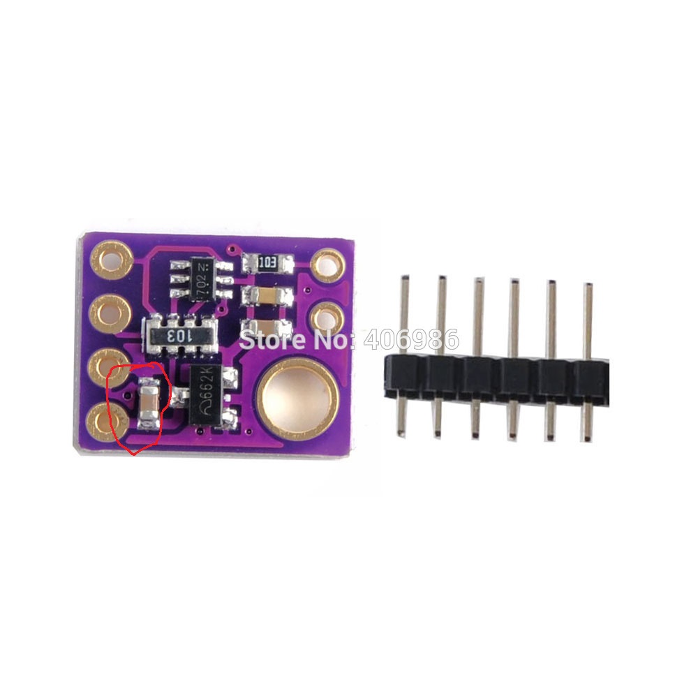

I have a gy1145 uv sensor which im playing setting up on my Rasp Pi/ I had it working and moving to outside in a box but upon moving the terminals from the bottom to the top i seem to have knocked the resistor and never to be seen again.
I can find info on what the resistor is and hoping one for you smart people may help.
Also if you can work out what value, would i be able to replace with a standard resistor just to get it working, Ive orders a new 2 from china (3 weeks wait at $3.40 each, or $22 each local :eek: )
i look forward to your help.

oops forgot to mark which one it was.

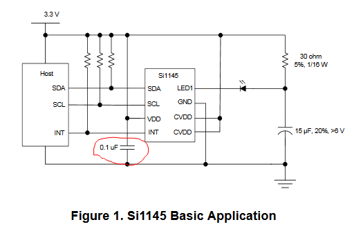

It appears to be connected between the bottom two pins which are Vin and Gnd so probably just a decoupling capacitor and almost any similar size (0805 ?) ceramic cap will work - 0.1μF to 10μF.
Edit, changed fron nF to μF,
