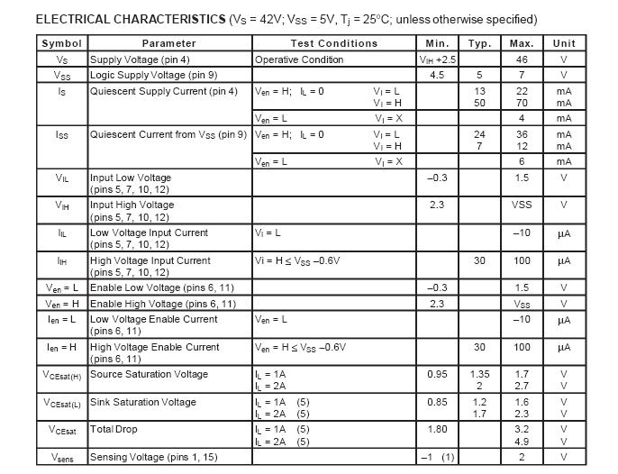

According to the datasheet, the maximum quiescent supply current,Is to the motor is in mA. Do we need a resistor at the Vs pin then?
I dont find it logical on how does a few mA able to output a maximum current of 2A.

Ok well quiescent current is when its not driving anything. So if u put enable low it will only use 4mA, assuming a resistor of 0.1Ohm is used:
P = iir = 16r = 1.6mW
But at the peak current of 2A
P = iir = 4r = 0.4W
So thats where the numbers come from...

Pin 15 needs a low resistor value to ground, or ground pin 15. The motor current goes through this resistor and its voltage drop must be no higher than 2.0V.
as the 2,3,13,14 pins are the output pins.......i should be getting 12v as corresponding output for driving the motor.............IS IT OKK??? ......................................but i am getting nothing.
You will never get 12V from the L298. Its max output high voltage is 2.7V and its max output low voltage is 2.3V. So the max loss is 5.0V plus the voltage dropped across the current-sense resistor.
