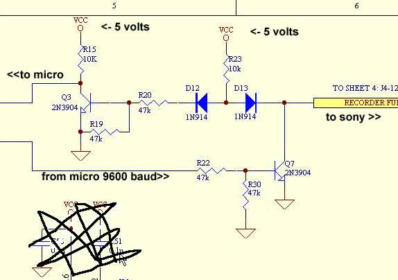

LANC is bi directional 9600 baud serial, 1 start bit 2 stop bits. The device under control continuously transmits data packets. The first two bytes are all zeros. This is where you insert commands. The remaining bytes are status bytes.
Heres what you have to do, Wait for the start bit of byte 1, do nothing for 1 bit time then send 8 data bits for the desired function. Dont bother with the stop bits their generated by the recorder.
I have attached a schematic of the lanc portion of one of my controllers.

from what I have read to comunacated with a sony camcorder via the Lanc from a pic micro the pic must have a open drain are open collector output. which the chips i have programmed 12f629/675 /16f630/676 do not. and because of the close timing need must be programmed in Assembly. working on this project I have found nothing but dead ends.
Not at all, it's similar to doing I2C - essentially you set the output pin permanently LOW, and use the TRIS register to switch the pin from input to output as you want it setting HIGH and LOW.

I believe I understand what your saying:
when your sending data to the camera I think your just shorting between Lanc and ground and open,you do this by output -low to short - switch to input for open. when your reading data to find the start bit the pin is a input.
so I could basically us any Pic chip.
Yes, any PIC.
