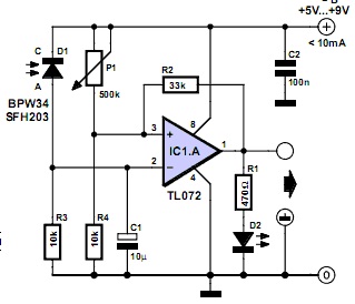

can anyone tell me what is the problem with this circuit. i have connected all the components as given but i am unable to switch off the alarm even when light falls on the photodiode.....plz help anyone..

The output will remain high when the (+) input is greater than the (-) input.
The 33k hysteresis resistor seems kind of small. Try 10 times that.
