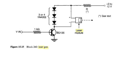

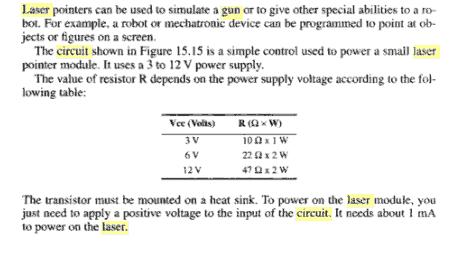

I found this circuit in the book 'Robotics, Mechatronics And Artificial Intelligence' by - Newton C. Braga
It seems like quite a simple circuit but i can't make head or tail of how it is supposed to act like a laser gun. Can anybody please explain to me its working?

And sorry for double-posting but, just to mention, the book doesn't give any explanation as to how the circuit functions. Any other model of laser gun with explanation is also welcome.
Its just a way of switching a 'laser pointer' ON/OFF using a transistor and a logic output,,, from somewhere?.
From my usage of laser pointers, the switching ON/OFF response is slow, so pulsed modulation is probably going to be limited.
Its a very inefficient way of switching a laserpointer.
Eric
I see. Thank you for clarifying, Nigel and ericgibbs. Can you guys tell me why the cascaded IN4002 configuration is being used in the collector?
Sorry for being a such a bugger. =^^=;
It's to drop the supply voltage to a suitable level for the laser pointer, the three diodes will give about 1.8V for the laser pointer.
