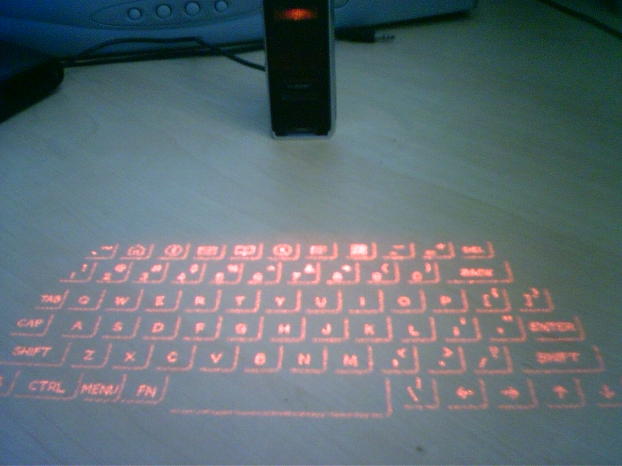

I've recently bought a laser keyboard (see attachment) and, apart from the fact that it appears to have an intermittent fault, when it is working I am extremely impressed with it.
I've been wondering how this works and I thought maybe one of you lot could offer a suggestion. How does the laser "paint" the image of the keyboard out? I'm assuming it must scan somehow and switch on/off at the right times to paint the graphics out. I can't see any moving mirrors that would create the scan though...
It's also quite impressive how it senses when your finger hits a key. I'm guessing it does this based on how far off the ground the laser projector is, and therefore it knows where the graphics will be displayed. It would probably only work when it is sat at a 90 degree angle to the desk. It really is very impressive though!

As far as image projection goes I'm going to bet it's probably a holographic lens. I've gotten them on a few 5 dollar gimicky laser pointers where you put on a different cap and it defracts the laser into little smiley faces or skulls or what not. Sensing is probably done with a cmos camera. It knows what image to expect when it's setup on a flat surface, so it can measure the displacement and hence where your fingers are, a little bit of proper timeing and knowledge of how people type and it's probably not too hard.

It's the angle the beam is projected at, it's very similar to the way a laser scanner works, it can tell when it's image is being displaced.
Having played around with the keyboard I don't think the laser has any function other than to project the image of the keys. It doesn't seem to have anything to do with recognising which key you've actually pressed. If I cover up the laser's window the image obviously dissapears but I can still type away!

Probably the below links would help you to understand the story of virtual keyboards.
https://www.vkb-support.com/learn_more.php
Acording to that link I was both right and wrong. Looks like the red laser template is just for show like Thermal said, the real goings on happen bellow with the IR laser diode parallel to the work surface and the cmos camera actually respoding to IR laser diode not the projected image, which could be of pretty much anything you wanted if you had the ability to create new hologram filters for the difraction element.
The laser diode parallel to the working surface actually makes a lot of sense, I think I might actually like one of these things, though I might have to learn to lift my fingers are little further off my keyboard than normal. There's no touch feedback at the key surface, and resting fingers would respond like a key being held down. Still nifty though. And eric is right, for stationary sitations this seems like it could be a very interesting.
