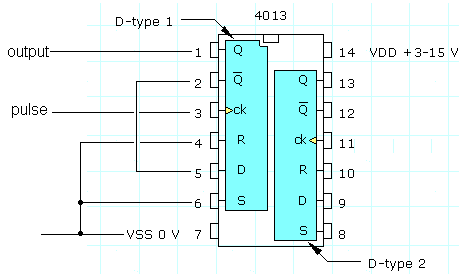

Ok well iv tried to neaten things up a little to get a better understanding of what i need to do, In this schematic i have a 4013 Dual D flip-flop CMOS IC?
down the left side is what i am using
is this the correct setup for what i want to do?
[A] I want to pulse the clock briefly and have the output (Q) stay high until the clock gets pulsed again?
Once the clock gets pulsed again the output (Q) will go low and stay low until the clock gets pulsed again, and so on?
[C] if this is correct do i need a pulldown resistor on the clock input if i a am using a momentary switch as my pulse?
and finally what do i do with the right side of the chip if its not in use?

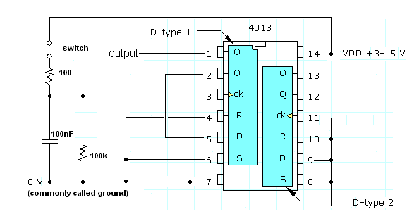

The problem with mechanical switches is that they don't switch cleanly. They bounce, creating several pulses each time the open, and each time they close. The bounce may last for several milliseconds (or more, if it is a large switch). Fortunately, you can debounce your switch with a couple of extra components. I used 3. The 100 ohm resistor is sometimes omitted. Including it limits the switch current into the capacitor, which otherwise might be several amps for a very short time.
The output will change state when you push the button, but not when you release it. This is called toggling, which has already been discussed. Is that what you want?

yes when i push the button and release it i want the output to remain high, and once i push and release the button again i want the output to go low and stay low, and so on

It will change state on the push, not on the release. Is that OK?
I Just set the schematic up and it works 100% with the 100nF in place,just a quick question, you have posted in your schematic a 100k resistor, i would have said 10k, i have used them both and they are equally effective?

The time constant is what's important. If you change the resistor to 10k, you have to change the capacitor to 1uF. 10k might not debounce reliably with 100nF.
Also - see my edit to my previous post.
im not sure if we are talking about the same resistor, im talking about the pulldown resistor from the clk pin to groung? is that the one you mean?
Yep, that's the one.
