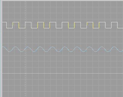

Q2) the second photo is for the signals : 1.comparator output (scale 5v) 2.non-inverting input (scale 1v) ,,, is the non-inverting input should be a sin wave (as shown) or a square wave (as i think)?
2.PNG figure 2 (for Q2)

R9 provides positive feedback to make IC2 an oscillator and its value equals that of bias resistors R7,R11 so that the hysteretic switching levels of the oscillator are at 1/3 and 2/3 of the supply voltage (5V). C9 provides AC coupling from pin 2 of IC2 to a parallel-resonant circuit made up of C6, L1 and whatever other L and C values are switched in via the relays or connected at Y1,Y2. The value of C9 is chosen to have a low AC impedance relative to that of the parallel-resonant circuit at resonance. It is this resonance which results in the sinewave input to pin 2 of IC2.

there is an Oscillation for a capacitor value between (10pf , 1uf)
for inductor value between (600nh , 100mh)

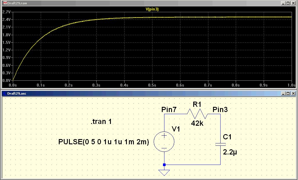

Q1) why the signal in inverting input is DC (2.5 v) ?
may be C10 doesn't discharge through R10 but why ?

Q1) R7,R11 (the bias resistors) are of equal value so form a voltage divider which halves the supply voltage.
R10,C10 form an integrator (low-pass filter) such that the voltage across C10 becomes the average of the changing voltage at pin 7 of IC2, i.e. becomes approximately 2.5V (half the supply voltage).
Q2) I should have referred to hypothetical hysteretic levels, since in practice C9 and the parallel-resonant circuit components load the pin 2 signal and prevent them being reached. If C9 were absent, but pin 7 could switch either high (5V) or low (0V), then R10 would be switched in parallel with either R7 or R11. R10 in parallel with R11 have a combined resistance Rpar of 50k, so the voltage at pin 2 would be 5V x Rpar/(R7 + Rpar) = 5V x 50k/150k = 5V x 1/3. Similarly, R10 in parallel with R7 have a combined resistance Rpar of 50k and the pin 2 voltage would then be 5V x R11/(R11+Rpar) = 5V x 100k/50k = 5V x 2/3.
That looks about right :).
Here's a simulation of the integrator action:
How do you get 27V? What are you using as Vin (remember the voltage at pin 7 is oscillating, not constant)?
See my edit to post #14.
So how i get 2.5v from the equation ?
and how match time it take to gave a fixed 2.5 volt , how i can calculate it?
The time taken will depend on at least the initial state of charge of C10, the output impedance of IC2, leakage current through C10, and resistor tolerances. In other words the calculation would be very difficult. If you assume the pin 7 oscillation has a 1:1 mark/space ratio and that pin 7 can be pulled rail-to-rail then the long-term average voltage is close to 50% of the supply voltage.
