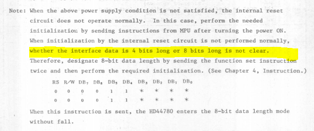

It is oft reported that the HD44780 comes up in an unknown state when the power-on reset is not done properly. Unfortunately, those sources simply state that as a fact and none, including Julyan Ilett, give a source for that information. In other words, maybe someone said it, and it just keeps getting repeated. It is hard to find a genuine copy of the HD44780S datasheet that the HD44780U replaced.
I did find a scanned version of the original (LCDII = HD44780S ?) datasheet in which that unknown state is described:
Source: **broken link removed** (March, 1981)
One might well interpret that in the way others have. However, "unclear" may also mean that the engineers at Hitachi hadn't been able to or hadn't tried to determine that state. Regardless of the interpretation of "unclear," a similar statement does not appear in the current datasheet. What might have been true about the HD44780/HD44780S might not apply to the HD44780U. Moreover, the current datasheet does state that the "Interface is 8 bits long" for both initializations by instruction following an improper power-on reset.
That information doesn't really change anything that has been said in this thread, except it does provide a source for the statement that at least some HD44780 versions came up in a state that was "not clear" in 1981.
In any event, we will continue to initialize by instruction as it has been done for the past 35 years.

alec_t
John
