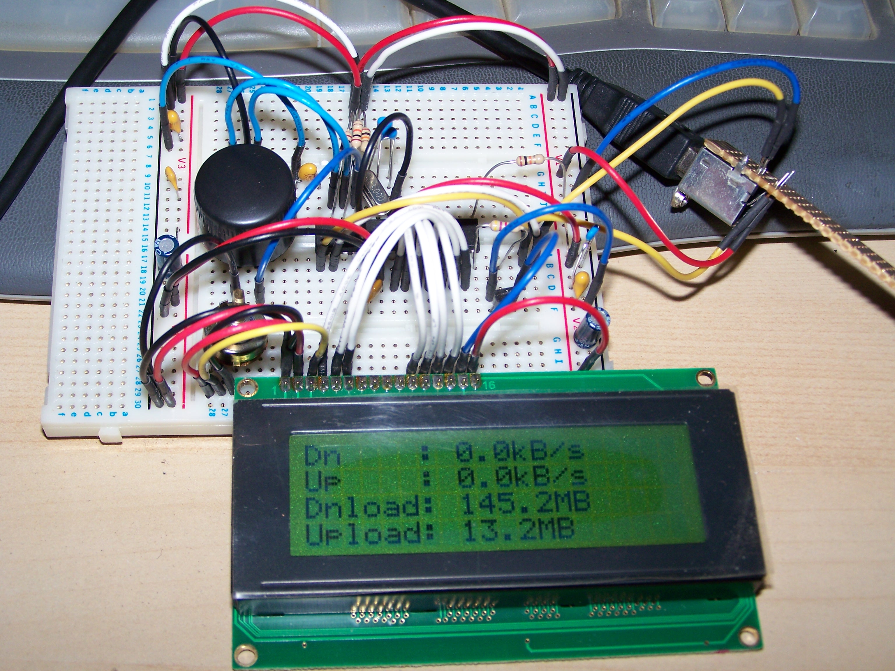

Was wondering if anyone had any tutorials or could help me to make the following:
I want to be able to connect a LCD display (i.e 2 line display) to a computer (using serial?) and write a piece of software to be able to control what is displayed on the LCD panel.
I have basic electronic knowladge, just need pointers as i couldnt find a tutorial myself. Thanks All.
Rhys
The problem is the LCD is parallel and serial is well... serial, so you need something to translate the data for you, a small micro controller would work. Do a search for linux LCD modules you should find better results that way as people have connected these types of LCD's to linux modules many times.

if you just want to be able to view 'stuff' from your PC on a separate LCD, without a huge amount of effort (as a newbie), have a look at the links below....
The hardware:
Make your own USB LCD controller! - bit-tech.net Forums
The software:
LCD Smartie - A free open-source LCD program!
I did this project in roughly 1 - 1 1/2 hours quite recently, on a breadboard.
You will need:
Hex file for the PIC (provided in the 1st link) + mchpcdc.inf file (also provided)
PIC18F2550
A way to program the above
4Mhz crystal & 2 x 22pF caps
100uF, 0.22uF & 0.1uF caps
10K & 4.7K resistors
5K pot
BC184L transistor (most small signal NPN will work - watch for pinout though)
A HD47780 compatible LCD
USB B socket & A to B lead
Breadboard & jumper leads
Some patience...
Please ignore the A-Team lash-up on the USB socket. :D
