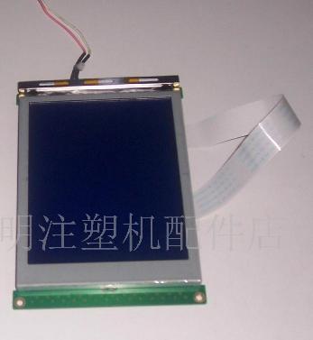

I have an LCD (Sharp L32019T). There are total 14 wires coming out of it. Two are for back and i need the pinout for the rest of the wires? Where can i find it
Secondly do i need to add an external controller in order to interface this lcd with a microcontroller?
here's a pic of what i have

Anyways... that is a Sharp Graphic LCD. but How do i program it and should i connect it directly to a microcontroller?

You obtain the datasheet for it from Sharp (if you can? - personally I'm doubtful that they will supply you one - google provides no hits on that number), then follow the details in the datasheet.
If you can't find a datasheet you're probably more stuffed than you already feel! :D
Where did you get this LCD from?
Let me guess eBay?
If so you could ask the seller and if they don't have it then sell it on to some other mug.:D
Heh,
Well, you're not 'stuffed' at all! I guess someone gave you the wrong part number, I've yet to see a Sharp LCD with a part number without the prefix 'LM', or 'LP' :D You can't expect those Ebay peeps to get everything right, after all, we get cheap LCD's out of the deal, just have to do our own research :D
Only one page, just the dimensions, optical specs etc..
https://pdf1.alldatasheet.com/datasheet-pdf/view/43107/SHARP/LM32019.html
Full datasheet for the entire LM320** series
https://www.electro-tech-online.com/custompdfs/2007/09/Sharp-LM32019.pdf
In case you're lazy, the pinout:
1. S (scan signal)
2. CP1 (data latch)
3. CP2 (data clock)
4. NC (no connection)
5. Disp OFF (L - OFF, H- ON)
6. D0 (datalines D0-D3)
7. D1
8. D2
9. D3 - (just noticed the previous mistake :D )
10. VDD (I would imagine 5v)
11. VSS (GND, 0V)
12. VEE (-16v to -22v, relative to GND)
Watch out for VEE, in many datasheet they provide a number with respect to VDD, which is 5v. So a quoted VEE of '-22v' is between VDD and VEE, so with repect to GND it would really be '-18v'. But don't worry, just use their recommended VEE circuit, with a potentiometer, so you can adjust contrast.
For a controller for a 320x240, I would recommend the epson S1D13700, which is newer than the SED1335 and has lots of extra goodies, including built in RAM. Plenty of info on the web in rigging it up. Its a hassle using controllerless LCD's....but it'll be worth it when you get LCDstudio up and running and see it in all its blue and white gorgeousness.

Ok i've got myself the SED1335... now how do I hook it up with it as the datasheet seems to be very confusing and the chip has a lot of pins.. Do i need all of them?
Can i get a schematic or something from somewhere?
Hey,
It all depends if you bought the sed1335 (or equiv) on its own, in which case you'll need a PCB made up, or....if you got a board already, with the sed1335, oscillator, and ram all ready on it? - These seems to be more available than the chip alone, like 'modules', very handy.
In answer to your question, you'll probably need most of them, however, the circuit can be broken down into four main area's:
1. Connection to the LCD - most likely 9-12 lines, D0-D3, the timing pins, etc..
2. Connection to 'host', be it a PC parallel port, or your microcontroller. This will be 8 I/O's (D0-D7), data latch (E/A), Read/write (R/W) and a reset.
3. Connection from the SED1335 to RAM. It'll need this to hold the 'bitmap' that the LCD is displaying, the SED just refreshes the screen from there. It needs 16 address lines, and 8 data lines.
4. Power and Oscillator. The SED1335 has a couple of power pins, and 2 pins for an external crystal OSC (or you could use a DIP oscillator module).
All the above equates to using pretty much all the pins on the chip, but I wouldn't worry too much, the RAM will take up about half of them, direct connections. In fact, as far as 'external components' go, you'll need the following:
RAM '62256'?
Crystal 8Mhz (I think!) with caps, 2 * 22pf
decoupling caps (100nF * 4)
Thats it!
Theres a quite a few schems on the web, a vast majority of them are for hooking up an 'already SED1335 equipped' LCD to the parallel port, but..there are some for adding an external controller:
**broken link removed** - poor quality
**broken link removed** - small app schem
http://www.woe.onlinehome.de/lcd.htm
http://www.woe.onlinehome.de/proj_gif/sed1335.gif - tried and tested
you can ignore the bottom half of the circuit, as thats for a microcontroller host, note the connection to the SED, a standard 'parallel' port type setup, 8 datalines and a few controll lines.
**broken link removed** - if you use eagle, you can nab the PCB design from this site.
http://www.gst-lcd.com/LCD사진/LCD controller/MSGO335A(TEST-KIT).pdf
I do have some schems of my own, from a basic setup with just the SED1335 and what it needds, all the way up to a full microcontroller system with the sed1335 on board.....its just a case of finding it, as I've recently replaced my HD and I can't find all my schems :eek:
I hope that will keep you going, just ask if you need anything else. You can worry about the 'VEE' circuit later, thats just a circuit to generate -14-22v form 5v, if you plan on powering it all form a single supply.
