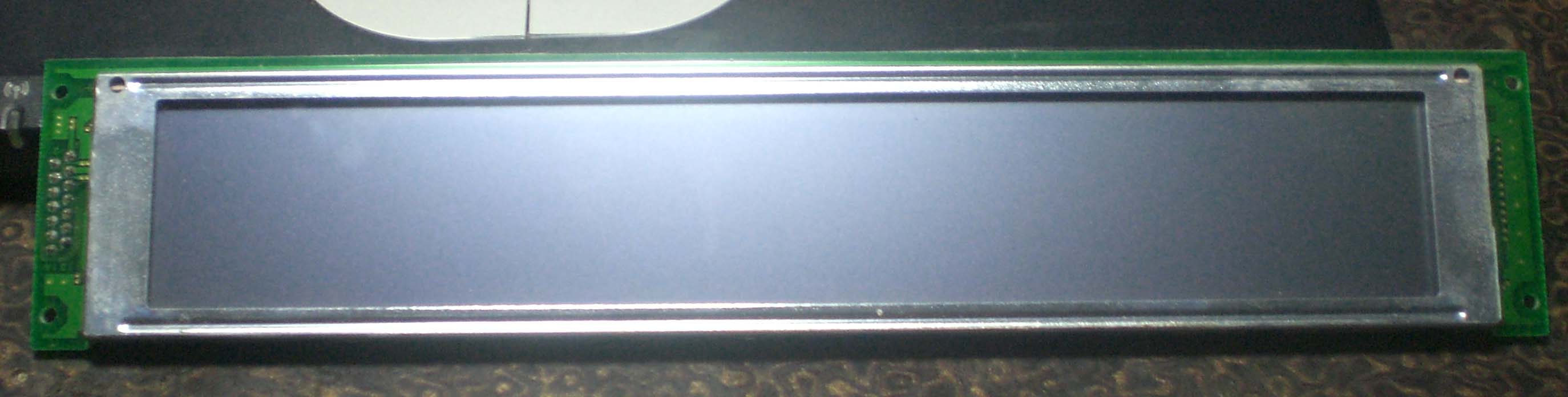

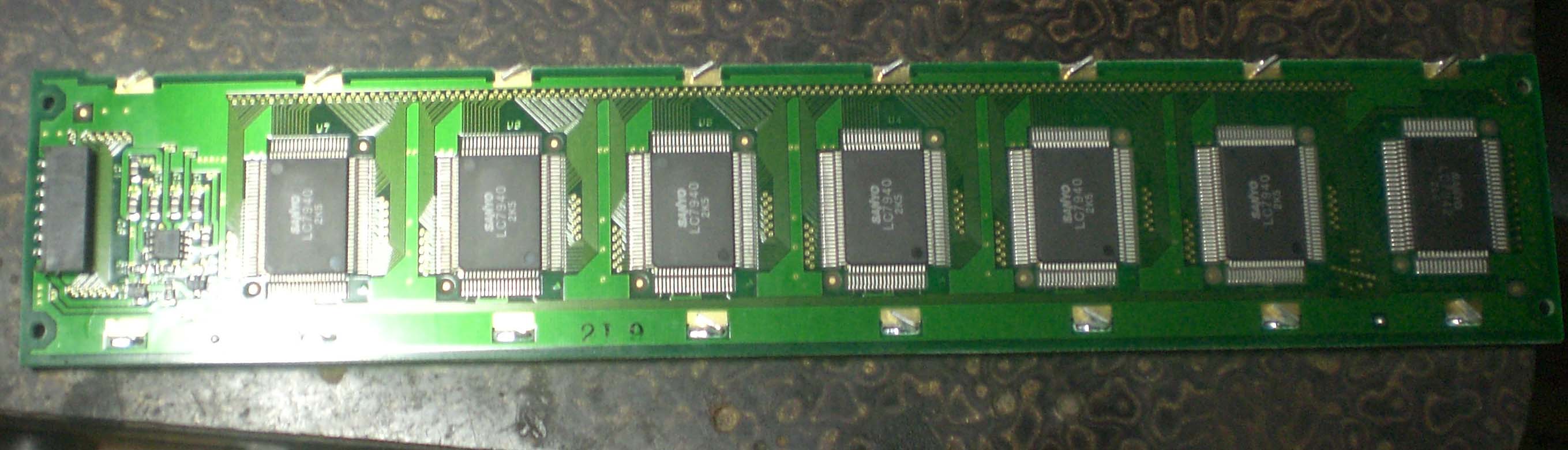

i have some old lcd module ,but i can't use it
please tell me about this !
The module have 14 pin
i think it config same the normal lcd module
pin 1:vss,2:vdd....13: Db7,14DB7
it 's not work
It's almost certainly a standard Hitachi compatible module - connect just power to it, and a contrast control, and you should be able to adjust the contrast to give a single line of black squares.
Here's a LCD tutorial you might find helpful
It starts out with the basics, using switches to input data, and advances to interfacing with MCUs.
