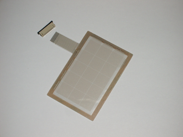

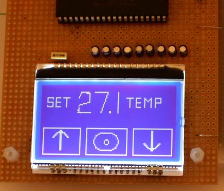

Probably something you may have looked at but discounted, is the use of glcd units.
They can be used a simple text screen, giving an equivalent display of 8 rows of 16 + characters, or with large character images as shown in the attached picture.
They are cost effective and practicable with simple assembler code, as can be seen in my recent post ( sorry the opening message photos deleted by mistake, but they are in the attached pdf)
https://www.electro-tech-online.com/threads/glcds-with-pic-18f-assembler.40676/
With a glcd there is so much scope for more information / options on the screen for the user to choose /select.
This also introduces the option of a touch screen as a practical reality for diyers - attached are pics of my current, very early, touch screen work.
The touch screen overlay and fdc connector costs under GB £10
( this 5x3 switch touch panel is the simple 'digital switch' type that is connected directly to the pic without a special controller chip)
Clearly this opens the way to a totally different menu system, but it should provide the user with the best possible information.
