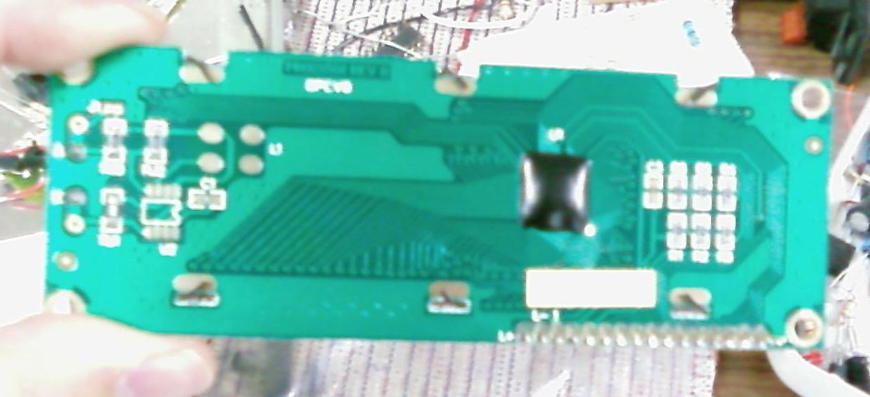

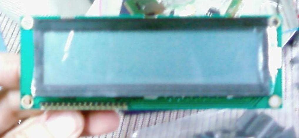

Hello, and sorry to bother you guys! but before i shake hands with all 3phases at work, maybe somebody can help me here.
I have a PIC, its a 16F877...and i have this 2x16 character LCD, which i think is a standard hitachi 44780 LCD. I think both the LCD and the PIC are working fine..seperately that is... when the LCD is connected to power supply, i see the first line is filled...nice...now the problem is that when i connect the display to the PIC... the display doesn't get initialized. nothing happens.. and the PIC dies..and it wont start/restart unless i disconnect the wires goin to the LCD
I tried tons of codes.. this has nothing to do with code.. i tried all ports and all configurations 4/8 bits... I'm sure i got the GND/VCC/contrast wires connected to the right pins since it shows the first line and the contrast thing works.. so i guess all the other pins follow in the standard manner RS/RW/E/D0-D7..
any comments would be much appreciated... thanks guys!!!
hey.. thanks for the prompt reply guys..
basically I think its a hardware issue since the pic wont work if the LCD is connected to power or to the pic... the second I disconnect the lcd power, the pic turns on. (I put some indicating leds). the schematics are exactly as the ones at your page, futz.. (is that a pullup 10K on R/S pin?? and why??)..
I thought maybe someone can identify this LCD, so I attached some bad quality photos.. on the back it has this yellow sticker that says HMC-16215 SG-LY-12-1 0033, so I searched, and found the manufacturer's page. as expected the datasheets can't be downloaded..
Ya, it's a Hitech unit
Their site, as you say, is absolutely useless. But most LCDs these days are pretty much standardized.
Yes, a RS pin pullup is needed. 4K7 is enough. I don't see it in my schematic though - guess I forgot. Actually, the EPE schematic I learned from recommends pullups on all lines except R/W and of course Vee, VDD & Gnd. I only did the RS one and it works fine.
