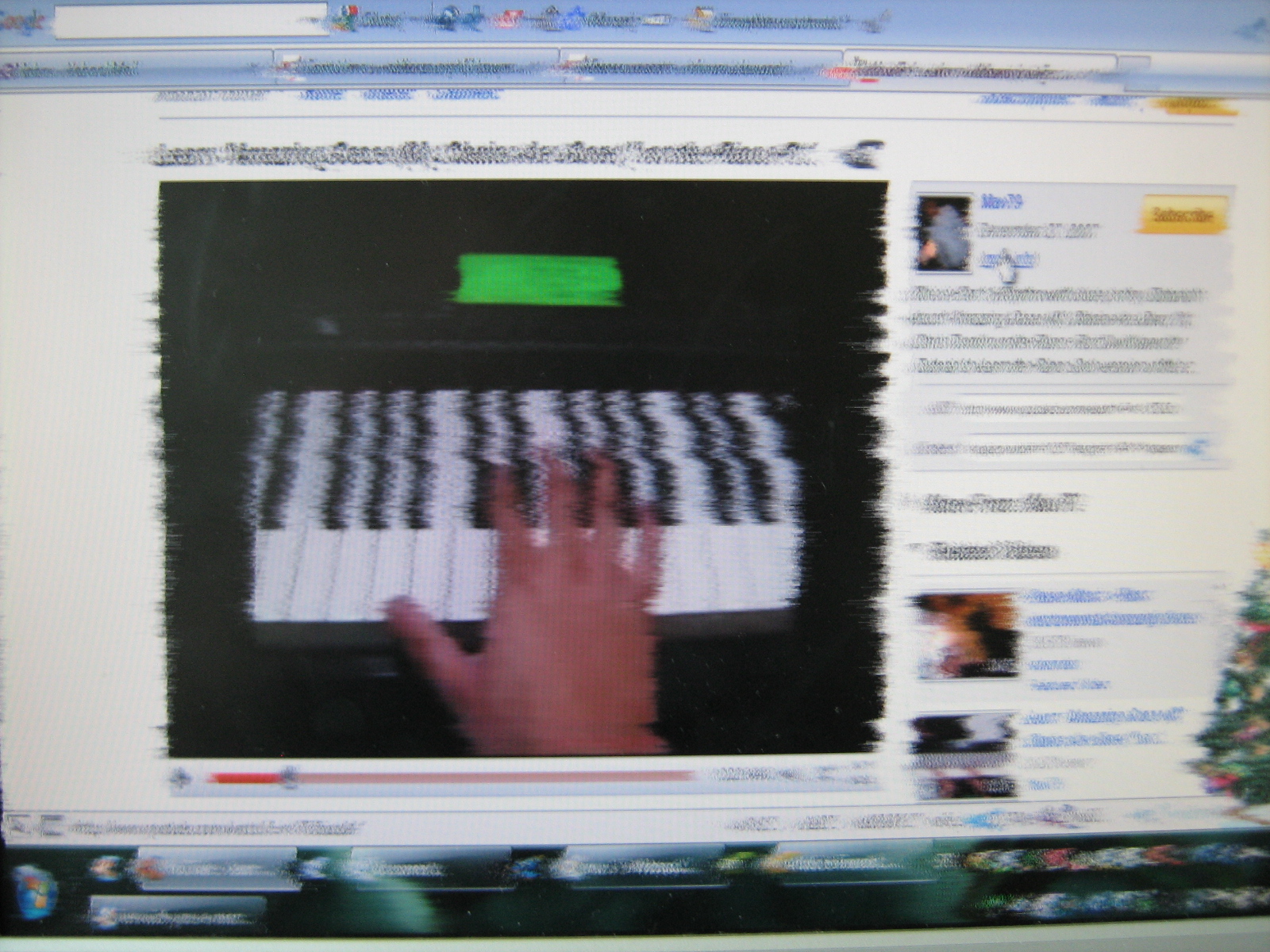

Hello,
I have a problem with a LCD monitor, i will describe it below.
The monitor displays the image from pc (VGA) but it shakes it horizontally. There are horizontal lines all over the image that move left-right for approx. 1-2 centimeters, vizible at the side. Basically, the entire image is moving left and right line by line simultanously.
The monitor itself is a Samsung SyncMaster 720N, 17 inch, 3 years old.
The most interesting fact is that the OSD of the monitor is displayed correctly, without any distorsion. So only the image that comes from pc is displayed wrong.

this is how the image looks
I wanted to post a photo taken of the monitor in cause, just so you can see how the image looks like (remember that the osd is fine if showed, no distorsion), just in case smb else will have a similar problem to find this thread.
