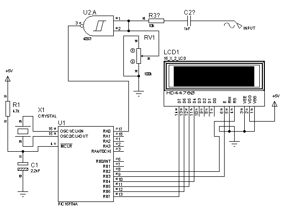

Here is what I come up in about a 45 min.
I did not have the chance to try in the real word /1am in the morning/, but it is working fine in the simulator.
Painfully simple, maybe not the most accurate,I think should be able to get down to the 5 RPM.
Look at the schematic and the code, I think it should be working fine.
If my math is incorrect again, you can easily adjust that.
Download Crownhill Picbasic Lite and compile with it.
If you want to check it out yourself before build it, get the Proteus DEMO.
DEVICE 16F84

   COUNT porta.0,1000,W0     ' COUNT FOR 1 SEC
   W0=(W0*10)/2
   CLS
   PRINT DEC W0*6," RPM  "
   GOTO START

The code I created is working fine, including the math..
Measured the signal, 66-68 Hz display 1980-2040 RPM, 116 Hz give me 3510 RPM...
It is only refresh 1/second, in the shop I worked long time ago, my friend had digital tachometer with infrared sensor, I remember his "PRO" toll need 2-3 sec for the firs reading, and after refresh not more than 1-2 times per second.

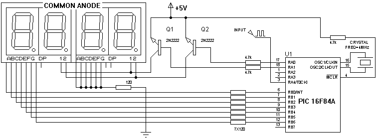

Here is a LED tachometer, I cant find the schematic, all I can find out from the .asm header" PIC D/A Tachometer by Harbanse Deogan", don't have any copyrights info so here you go.
I changed the 7seg pattern for common anode, all I have is CA display's.
I draw a schematic since all I have is the ASM file.
You have to come up with your own circuit for the input !! DO NOT CONNECT DIRECTLY TO THE IGNITION COIL !

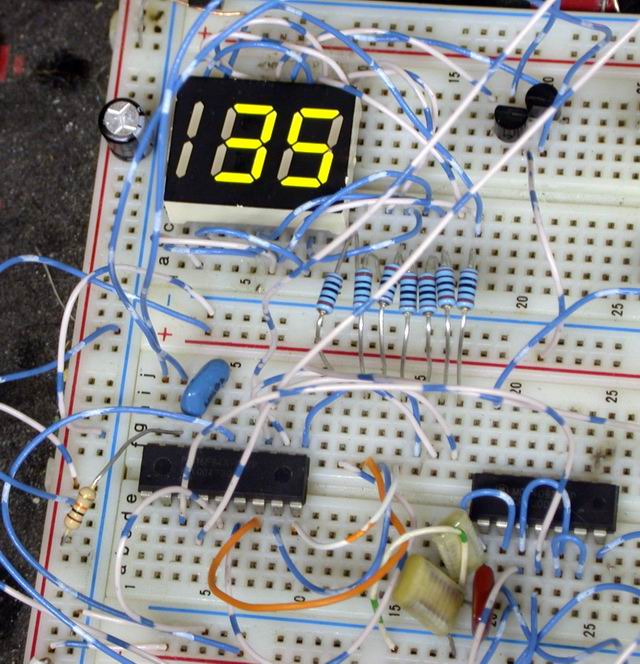

Tried on the breadboard, working !
God luck.

I built the led tachometer circuit and worked fine (although the leading zero, when rpm is below 1000, appears as an eight).
My main problem is that I want to use it on my motorcycle, which has a 2-cylinder, four stroke engine with two separate ignition coils.
So, for every two revolutions of the engine, I will pick up one pulse (spark) from any-one of the ignition coils. Is that correct?
Is there a link I can download the original .asm file to try and modify it for my needs?
Any extra help is more than welcome.
You are right, below 1000 rpm the msd shows #8. I'll check why is that.
I did not change anything other then LED patterns in the ASM file.

Steve, I think there was an error in your display patterns.
I corrected it.
I played around a bit and I encountered a different problem. When using code with common cathode patterns on a common cathode display, multiplexing doesn't work properly and both numbers appear (slightly) on both digits. If I use the common anode patterns code, a 74LS14 inverter and a common cathode display, it works fine!
I even tried changing the multiplexing timing subroutines but nothing happened.
Following is the original code (with the correct display patterns for steve's common anode display led tachometer), can anyone give it a try and tell me if it works? I don't know, maybe it's my display!
