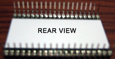

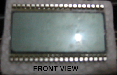

Hi everyone!
Could someone tell me this 3.5 digit 7-Segment-LCD's pin configuration?
Thanks!

There's no driver on that device. Even if you had the pinout, you can't just add 5v to a segment and make it turn black, it uses AC with some specific specs. Basically, it's impractical to drive these without a special ASIC even if you got it free. An alphanumeric display with a built-in driver/controller is the way to go.
So, just adding a Vcc and testing which segment is lit? I intend to use it with a microcontroller to display, for example, a temperature value.
You've got to do a LOT of work to use that, it's probably not worth the trouble?, unless you can get a driver IC for it?.
You can't just do what you suggest, LCD's require AC signals, it's fairly complicated to do, usually you use XOR gates to feed all the sections, with an oscillator feeding the other XOR inputs. Some micro-controllers are designed specifically for this purpose, and it's all built-in.

I'd use an MM5453 chip from National Semiconductor if you intend to use it with a processor. It should have no trouble driving that display, as it has 33 outputs for a display like that. You communicate with it using a synchronous serial data stream. You can get them from Jameco, here's a link to a datasheet: **broken link removed**
