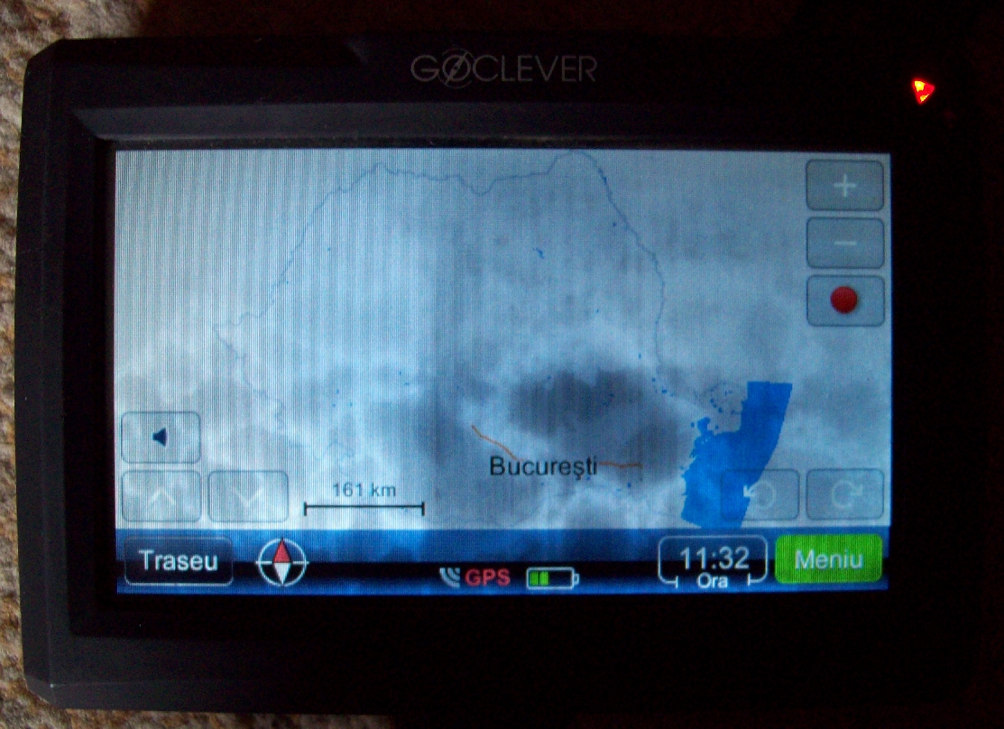

Hello,
I have a GPS. Recently i dropped a glass of medical alcohol on it. I took it apart to let the alcohol dry. When i powered it on, i noticed some dark stains behind the screen. The colors are OK , but that area is like lacking contrast, the image is lesss visible, especially when it shows white background... What happened?
Ok. Is there a possibility to get the alcohol out of there? Maybe if i heat a little the screen with a hair dryer?
The alcohol should have evaporated anyway, it's the residue left behind that's the problem - you would need to disassemble the display and clean it - but I suspect that's VERY likely to destroy it.
What was your medicinal alcohol mixed with? Usually take mine with orange juice... :) Seriously though, have you checked underneath the LCD? There is usually several layers of stuff, for the back-lighting, diffuser, reflector, filter... Maybe your damage isn't the LCD itself, but one of the lighting elements underneath. I have taken a few apart, broken, out of curiosity, LCD projector idea, or different back-light scheme, and the layers are usually just stacked up and held in place with metal tabs.
I like to drink it on the rocks :)))) Well, i didn't dismantle it, but i can see a protective white sheet , like polyethylene bags. Probably that layer is a reflective one and the alcohol dissolved he glue. I don't know, i'm just guessing...
Sometimes the very thin polarizing sheet is damaged by chemicals. I have replaced them with some from Edmund Scientific. Back in the day when I could grind odd-shaped watch crystals and had access to meturgical grinders and diamond saws.
