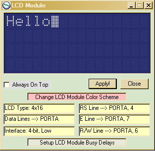

Then simulat the program using PROTUSE. However the LCD shows nothing.
Please help me :confused:

Hi Nigel,
For reference only, Tut#3 works fine in Oshonsoft, as do all your others that I have tried for OP's.

I traid to simulat the circuit in Oshonsoft. However nothing shows in the LCD.
Did you set up the Oshonsoft LCD module.??
Run at Ultimate Rate and wait until the Program delays time out. takes about 5 to 10 seconds.
