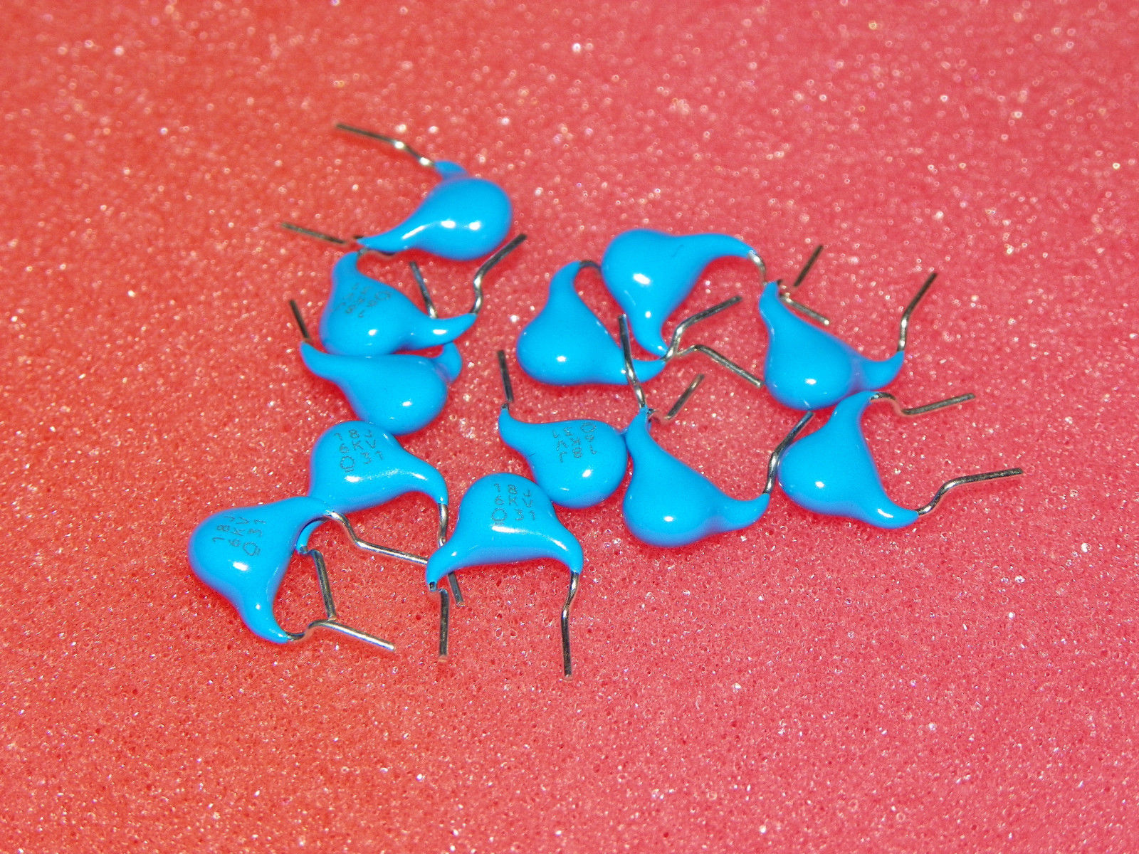

I am trying to repair an LCD TV - Apex LD4688T inverter balance board because the part is not avail. They sell the inverter but not the so called balance board. They do however sell the capacitors to repair the original board in which I do not have. The board looks simple with only these capacitors on it. It has one two wire connector that goes to all of the capacitors and then the bulbs. Any help on how to go about hooking these capacitors up would be greatly appreciated .

Looking closer at the boards image it looks like each side of the backlight tubes goes through these devices to a common connection, maybe ground, such being the case I suspect that they are mov varistors not caps, probably so if 1 or more backlight tubes fail the devices conduct and prevent the others from becoming unbalanced current wise, hence balance board, if they definately are caps then it wouldnt make sense for them all to go to one common, you cant see the other side of the board or the connectors properly so this might not even be the way its configured.
I dont think I can offer much more assistance.

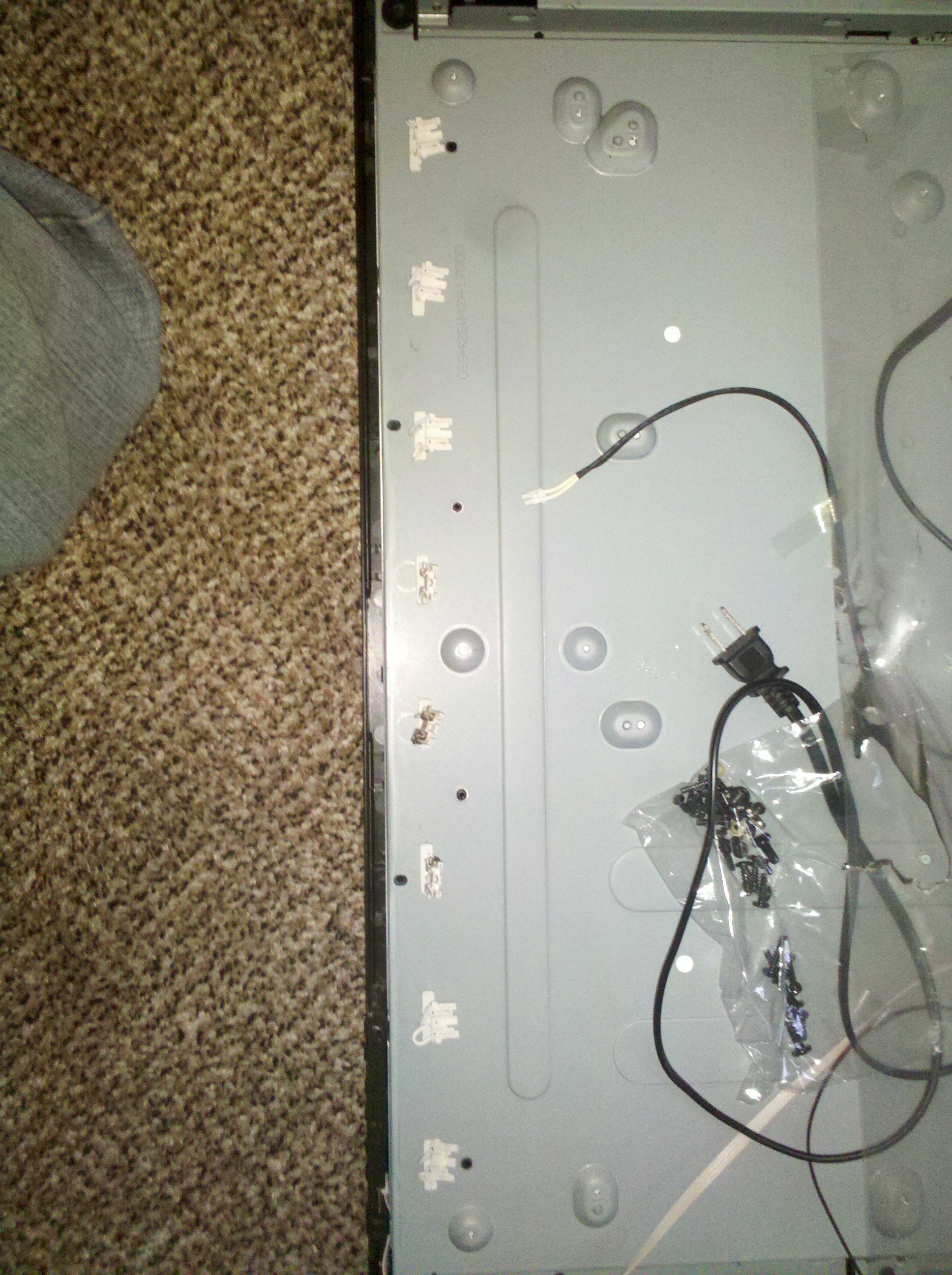

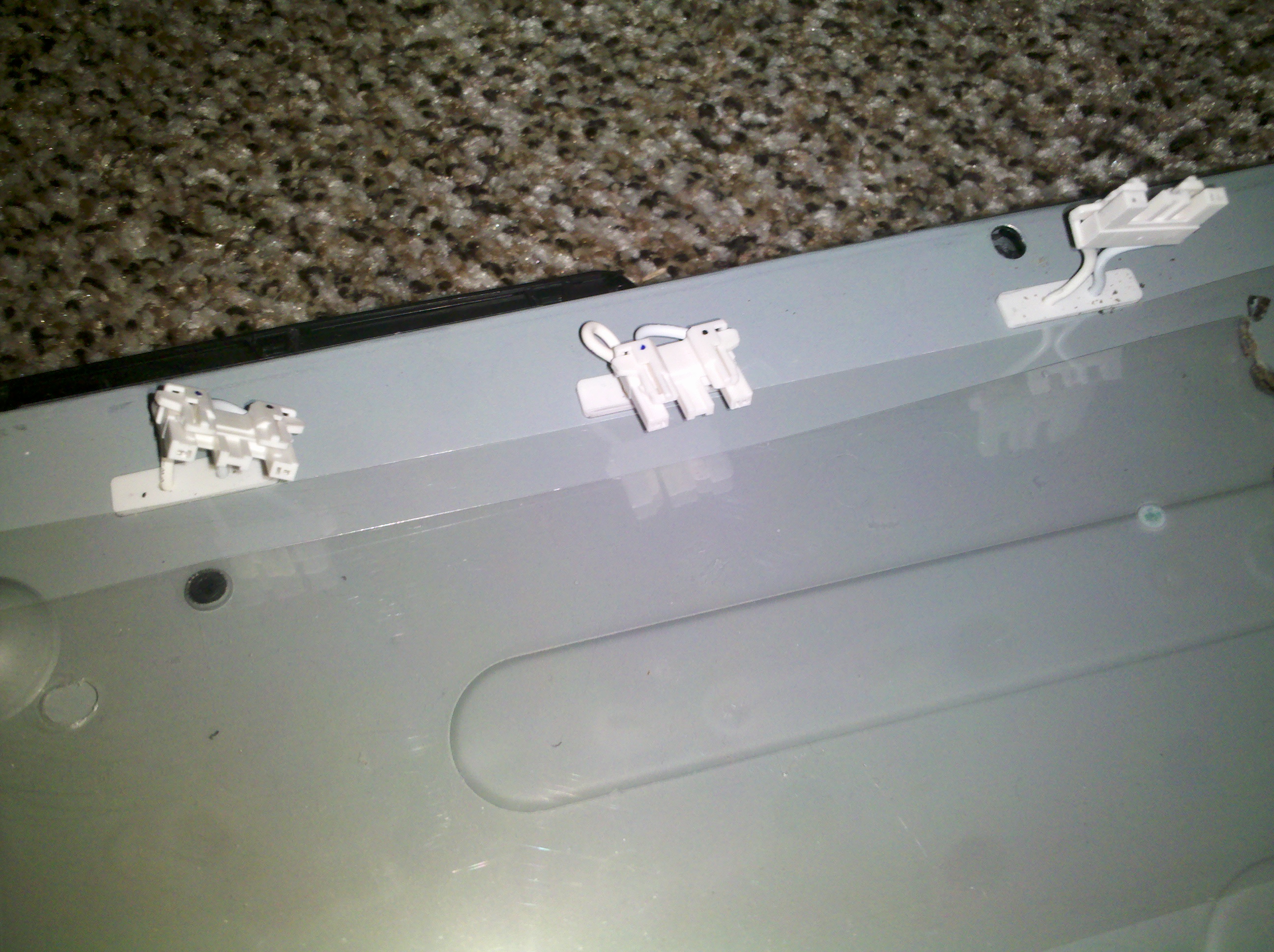

Thanks for your help guy's, this is what they sell for repair kits for these TDK 18pf 6kv High voltage Capacitors and I ordered them. I may end up as a last resort of research just taking the lcd apart and hope I don't destoy it in the process lol.
OK so they are caps.
I just routed through some of my scrap stock, found a couple of hv generator boards but no balance ones, if I had one then I migh thave been able to see how they are connected.
I wouldnt take apart the lcd, but then whats to lose.
