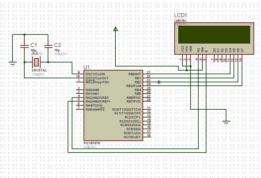

dear all
iwant to interface a lcd 2X 16 line hd44780 with pic16f876a using HITECH C .i am not able to get anything written on the screen. i am sendimng the code .please check wht is the mistake.

void main(void)
TRISA = 0x00; // control lines are output
PORTA = 0x00; // control lines are output
TRISB = 0x00; // Make all Port B data lines output
PORTB = 0x00; // Make all Port B data lines output
lcd_init();
while(1)
lcd_goto(0x04);
lcd_putch('A');
