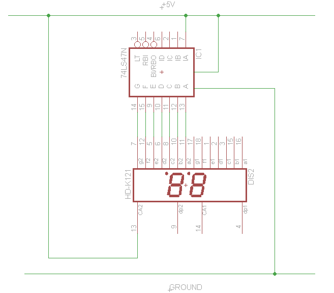

Any idea why this won't work?
I would expect it to do something??

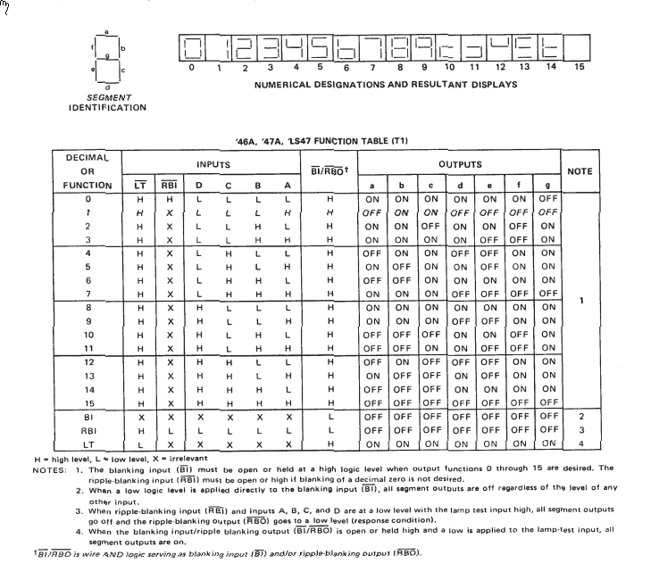

An open input on pins A,B,C,D will assume a logic high, the decode for all high is BLANK led.
Connect A,B,C,D to 0V and the LED should display '0'

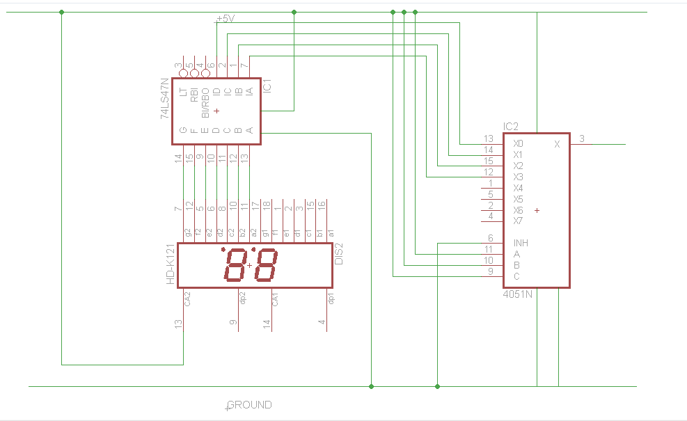

OK. Next I am trying to connect the above to 4051.
I don't know what connect Pin 3 to. I presume high?
I tried high (and low).... and then connected A, B and C to high in an attempt to get something to happen but nothing did.
Any ideas? (cheers for ya time btw. it is much appreciated)
