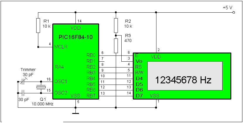

I swap the :
LcdE equ 0 ; enable Lcd
LcdRw equ 3 ; read Lcd
with this
LcdE equ 3 ; read Lcd
LcdRw equ 0 ; enable Lcd
but the below code isn't work
Before swap the code work
;*	PORTB:	0 LCD Display E
;*		1
;*		2 LCD Display RS
;*		3 LCD Display R/W
;*		4-7 LCD Display D4 .. D7
PORTC	equ	PORTB		; LCD-Control-Port
PORTD	equ	PORTB		; LCD-Daten-Port
LcdRs	equ	2		; Data Lcd (not control)

Some of the code is writing to portb, some to portc and some portd. How have you got your LCD connected?
like this and works
but i want to swap the E with RW or to ground the RW
I see, you have equated portc and portd as portb - how confusing.
I can't see why it shouldn't work. Maybe you should go through the code and replace all port accesses with portb - you might then be able to spot the error.
If you want to ground RW then you need to replace the busy test with a delay.
savnik said:
Because only write to lcd , not read.
You are testing the BUSY bit with a READ!
btfsc LcdStatus, 7 ; test bit 7
Eric
Leave it as it is, it makes for the fastest possible updating speed of the LCD, otherwise you have to introduce fixed delays, which waste time. The read is to check the busy flag, so it never waits longer than it needs to.
