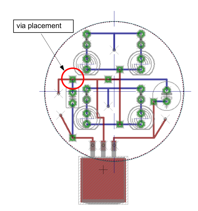

Another question, can I place the via like shown in the picture, direct on the wire?
