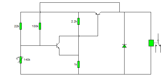

You could try this thermostat circuit I designed awhile ago, but replace the thermister with an LDR and the relay with an LED, the good thing is it has hysteresis to prevent oscillation.
thanks, which npn and pnp should i use? can it be 2N3904 and BC327? how about the diode? Is IN34 enough? Vcc to the 22K and GND to end of LDR right? I thought i need a VR to adjust the sensitivity?

Yes you doo need a variable resistor, I was making you think, I did say it needs some modifications for it to work as you expect.
mramos1 said:
Does this help
There's nothing worng with that circuit but it depends on what you want to do, it's fine for switching low power loads with a relay but I wouldn't use it at high powers as the relay isn't snapped on and off, the current throught the coil changes slowly thus softening the switching action which can cause arcing at the contacts at high currents - not important for this application I'm just explaining things.
bananasiong said:
thanks for that!! can i just replace the relay with a LED or a bulb?
Yes you can, (as I said before) this circuit is fine but you'll notice that the LED or bulb won't turn on or suddenly but will slowly get brighter or dimmer and it might vary with the temperature, is this behaviour acceptable?
Also it isn't suitable for large light bulbs or high powered LEDs since the transistor will be getting quite warm when it isn't fully saturated.
My circuit solves these problems (although it uses more parts) the LED/bulb will suddenly turn on or off, and it includes some hysteresis to help prevent oscillation.

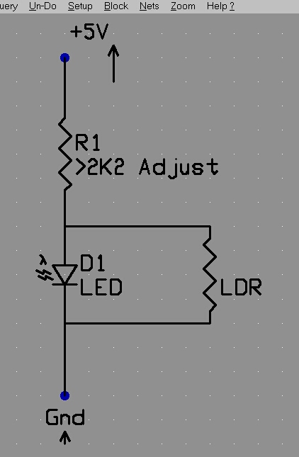

Ldr Ckt
something simple like this do? :D
Wow that so simple it blows my mind...does it work? Im not sure what LDR stands for, but I assume it outputs a voltage depending on brightness?
It sure does! Light Dependent Resistor
In bright light, LDR is low resistance and shorts out the LED.
In Darkness, LDR is Hi resistance (>2Mohms) and led lights.
In between the led dims proportionally, in an analog fashion.
Ldr
I think you can replace the LDR with a photo-transistor in Docel's circuit if you want on/off operation instead of dimming control...or it might end up doing the same thing if the switching thresholds of the transistor isn't narrow enough and the transistor's analog behaviour starts kicking in.
The LED won't be very bright with that circuit, the current will only be about 1.5mA in absolute darkness so you really want to be using one of those ultra bright ultra low current LEDs.
