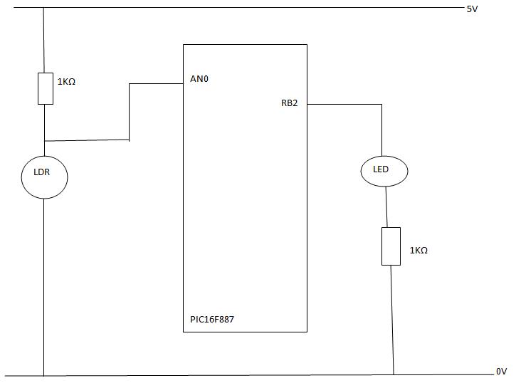

Can anyone help me find any mistake on the code and the circuit diagram. My aim is to light the LED if it is dark and turn it off if it is bright using LDR sensor. I have written the code and tested it on MPLAB and constructed the circuit diagram as shown on the attachment but the LED did not light, may be the circuit diagram is not complete or the code is wrong, i would be pleased if i can find solution. My code looks like this

Your circuit diagram is incomplete!, please post the full circuit diagram for the project.:)

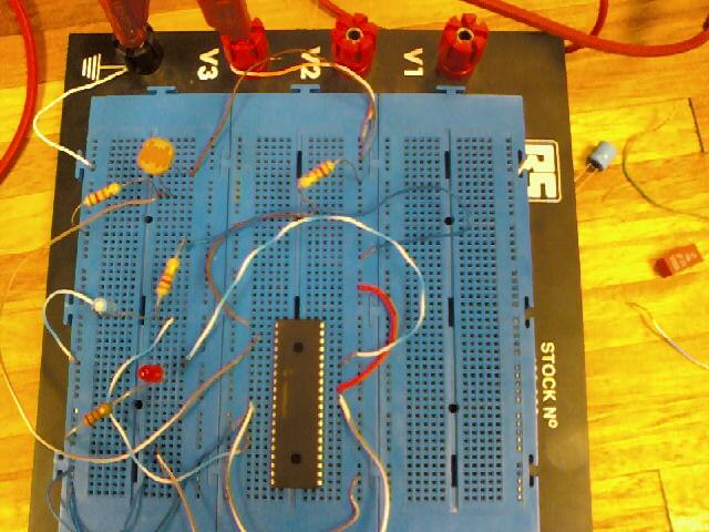

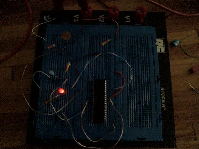

Hi, i have figured out how to construct a complete circuit diagram, look at the attachment. i want to replace LDR with Infrared photo detector (rs: 2017729). Could you please tell me what is the output voltage of infrared photo detector when it captures motion and when there is no motion. Its because with LDR, i know that its output voltage is less than 2.5v when it is dark and greater than 2.5v when it is bright.

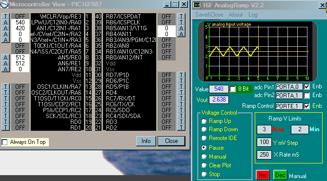

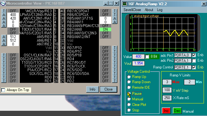

The LED works ok in the Oshonsoft simulator.
LED is off when AN0 > 2.5V and on when AN0 > 2.5V.
See the attachments.
Hello Sir, I have been trying to analyse the result of Oshonsoft simulator, could you please tell me about the yellow wave form, what does it show? and why is its amplitute between 2 and 3?. I can understant that pin 35(RB2) is on because it is where LED is connected and it shows that LED is turned on. I would say other pins are off because they are not connected, but I am suprised to see that pin 1(Vpp) is off. from there, I would like to know what does 400,420,0 and 0 on pins 2,3,4 and 5 respectively means. Also 0 and 0 on pin 35 and 37. I'm, I correct to say Vout of 1.954v is the output voltage of LDR sensor and 400 is the corresponding digital number converted from analog voltage of 1.954v. I would be very happy to get your valuable reply.
